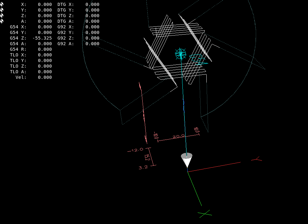

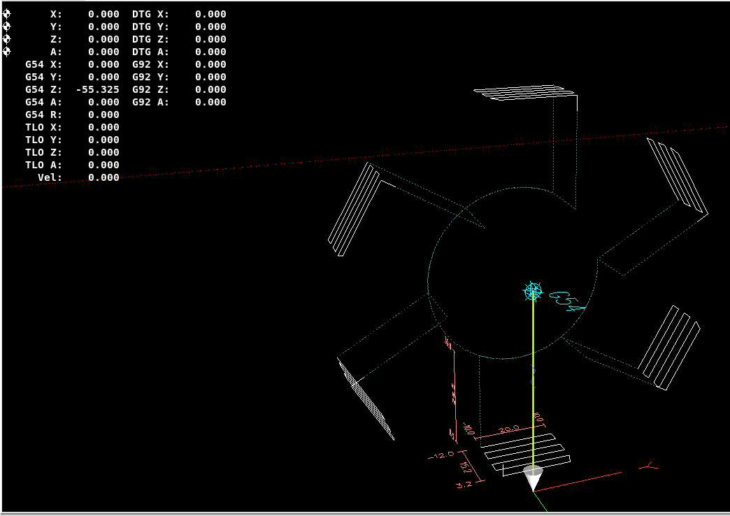

Hello
I'm just starting to play with 4 axis configuration and trying to mill 6 faces out of a 20mm rod.
In linuxcnc all looks good only when I don't have any G54 Z offset.
But if I have an offset on the Z axis, it looks strange.
Do I must move my machine origine to the A axis to be able to have a nice preview ?

28 Jan 2023 17:34 #263099
Replied by andypugh on topic A axis position
The G-code preview assumes that the centre of rotation is the axis zero.
You just have to accept that the preview in rotary mode is nothing more than an indication. (The preview has no way to know where your axis of rotation is, the G-code does not include that information)

28 Jan 2023 17:52 #263102
by looping
Replied by looping on topic A axis position
I agree but the preview is just an indication but in this case it is misleading : On the second preview it may look like the path will be out of machine boundaries but in fact it is not.
The axis position, as it is machine dependent, should rather be in the INI fileThe preview has no way to know where your axis of rotation is, the G-code does not include that information)

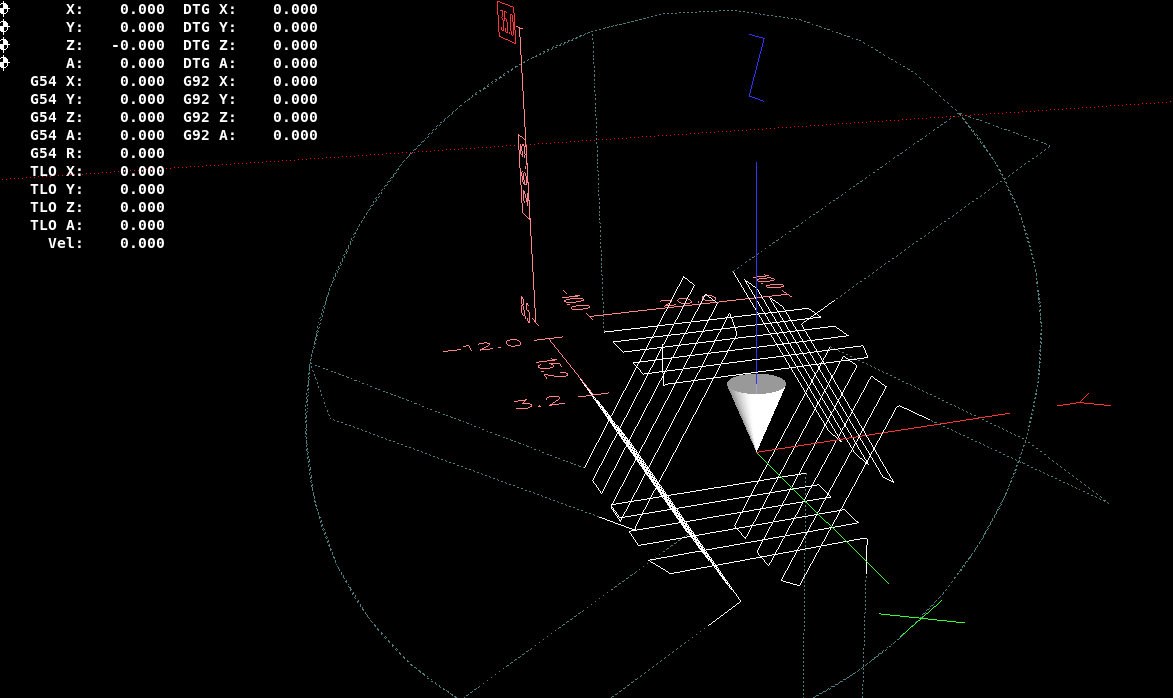

28 Jan 2023 19:48 #263108
by dgarrett
Replied by dgarrett on topic A axis position
2.9 and up:
> 10. Rotations applied after translations may use the "!" provision to act with
> respect to the current machine offset. Example: GEOMETRY=!CXYZ translates the
> control point to the X, Y, Z position and then performs a C rotation about the
> machine origin displaced by the current G5x,G92 X, Y, Z offsets. (Changing
> offsets may require a program reload).
Ref:
linuxcnc.org/docs/2.9/html/config/ini-config.html
github.com/LinuxCNC/linuxcnc/commit/c392629
Ref:

29 Jan 2023 20:00 #263181
by looping
I upgraded LinuxCnc to the last buildbot version and updated my INI file with :
[DISPLAY]
GEOMETRY = !AXYZ
Did I miss something ?
[DISPLAY]
GEOMETRY = !AXYZ

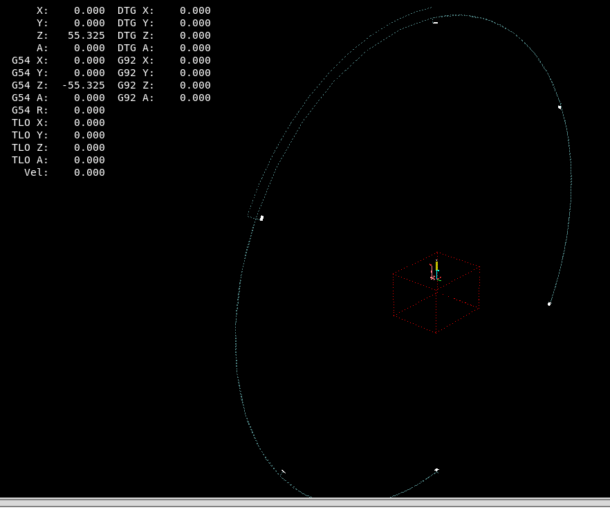

02 Feb 2023 19:23 #263542
by looping
- Thank you received: 4654
04 Feb 2023 11:13 #263660
Or maybe an INI entry, but that couldn't be changed at runtime.
The only way I see round this is to add a "magic comment" that the preview could parse. Something like (ORIGIN, 100 0 0)The build (>=758) improved a bit, but still some work to be done : The shape of the path is now correct with or without an offset.
But the path remains located on the machine origin.
