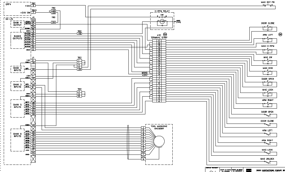

Thank you for the reply.
As you say the console is far away from the cabinet so having the computer close to the console would certainly solve a lot of problems. Was thinking of having a touch display as well which the touch is operated over USB. A solution could be using a repeater cable but this should then be tested before installing it in the machine.
I have seen your thread before and am a little confused.
I do not think my machine has a tool changer board, it has a relay board that I am currently trying to decide if it is going to be exchanged for DIN mounted relays the toolchanger should not be connected to that.
The toolchanger schematics for my machine looks like in the attachment, so it should just IOs i guess.
The ATC terminal strip I am currently not aware of where it is placed. Think it is on top of the machine on the toolchanger itself but could be wrong. Have not had the machine for that long so have not inspected it that close yet.
Will post the progress as it comes along, and will probably have more questions along the way.

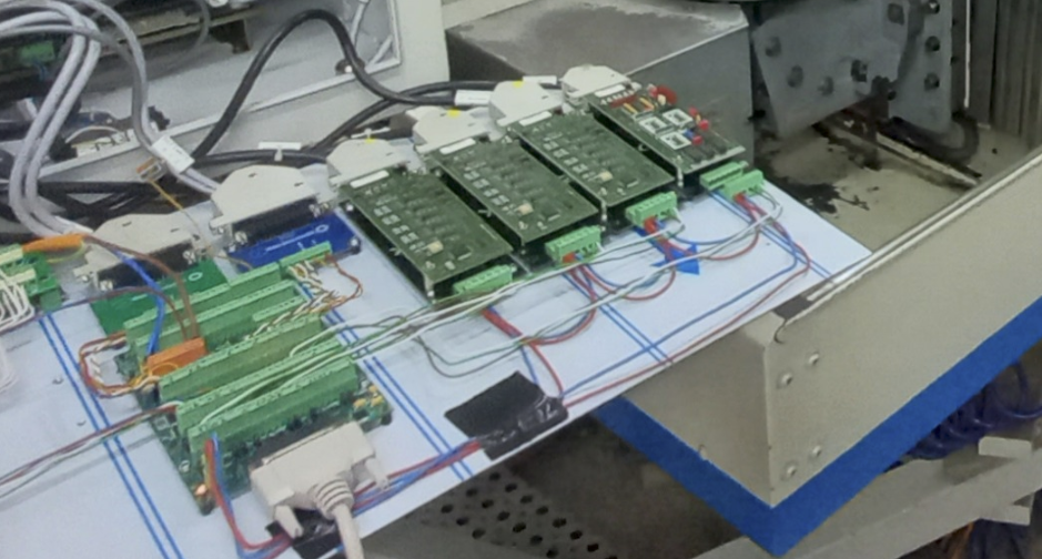

I saw a detail in your thread that i wounder a little about, specially in this these screen dump:
What are the boards to the right? Are these original from your machine or is it some special cards to hook up the cables for the drives?
Yes my machine also has simodrive 611:s. Seems to be a littlebit diffrent setup though. The BMC has the encoder feedback hooked up to the controller, only the spindle feedback is hooked up directly to the drive.
I do not know is this is bennifitial, time will tell .

28 Feb 2024 21:14 - 28 Feb 2024 21:15 #294725
by Wieser
Replied by Wieser on topic Retrofitting HURCO BMC30
Those on top are the original Siemens Sinusoidal to TTL "EXEs". They were mounted inside the Siemens 820M Control.
I built simple PCB adapter cards with the correct DB-connector to interface the encoder scales to those in my setup and added a screw terminal for 5V power supply of the encoders and A, B and Index output.
In my case all axes including the spindle have a tacho feedback directly into the Simudrive and all the encoders were connected to the controller. If your encoders are similar (DB15 and same pinout), I have four of them left.
PS. if anyone sees that EXE at the right, that is for a rotating axis and it needs 15V on a specific pin to function correctly, that was a pain to find out.
PSS. If somebody has datasheets for those, they still would be highly appreciated since they have more pins to send a fault/hardware missing signal to the controller and I don’t have them incorporated yet.
