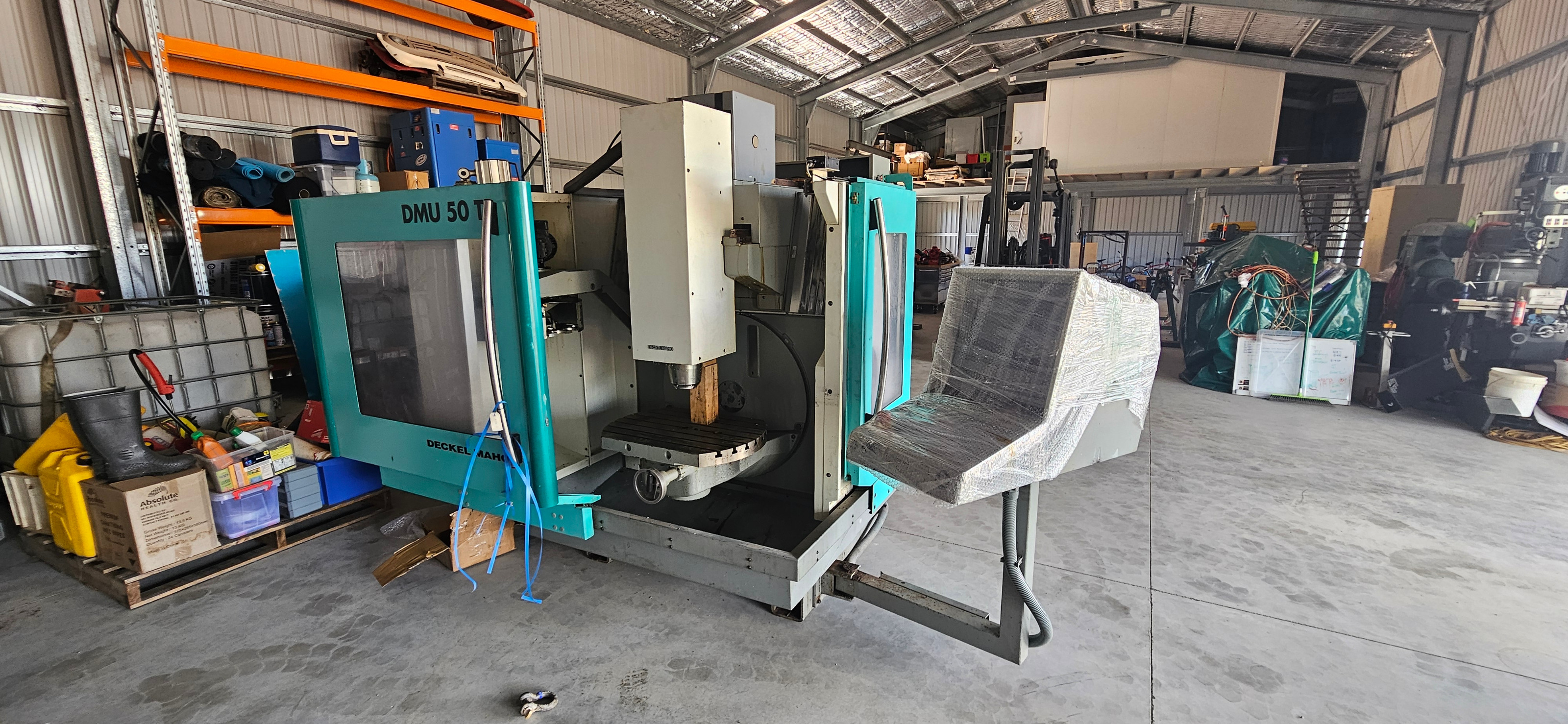

Hi guys as the title says I am planning on retro-fit to my 1997 Deckel-Maho DMU 50T. It is a 3 axis machine with 2 manual axis’s on the table. 16pos ATC.
I was about to pull the trigger on a Centroid Oak system, but it appears they don't support my drives, so I got to more searching and found / re-found linuxcnc. So here I am, after searching this forum and watching some (many) youtube vids I think I am better off here. Below is copy pasted from my post over there.
My machine currently has the following controls and drives.
* Heidenhain TNC 426 cnc controller
* Siemens 611 drives fitted with a Heidenhain interface control card / board.
* Siemens Servo motors – 1FK6 series with 1Vpp encoders feed back direct to the TNC
* Siemens spindle motor - 1PH6 series with 1Vpp encoder fed back direct to the TNC
* Heidenhain LS486 linear scales on the X, Y, Z. +-5um accuracy ( I think, still looking for exact specs on these)
*Manual axis’s have Heidenhain ROD280 encoders on them both.
I have only just unloaded it from the truck, I have not yet had it powered up but it had been inspected and running before I bought it. I would like to change to a more modern system, hopefully the sale of all the TNC hardware will help too. It is in very good condition.
I have come up with the following solutions to the conversion requirements if you could please have a look and see if I am in the right direction.

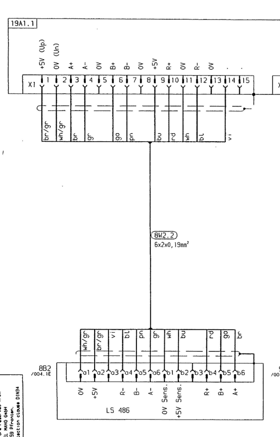

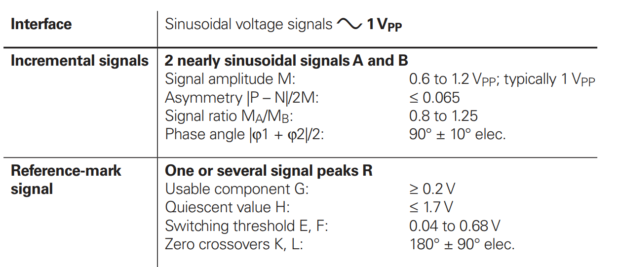

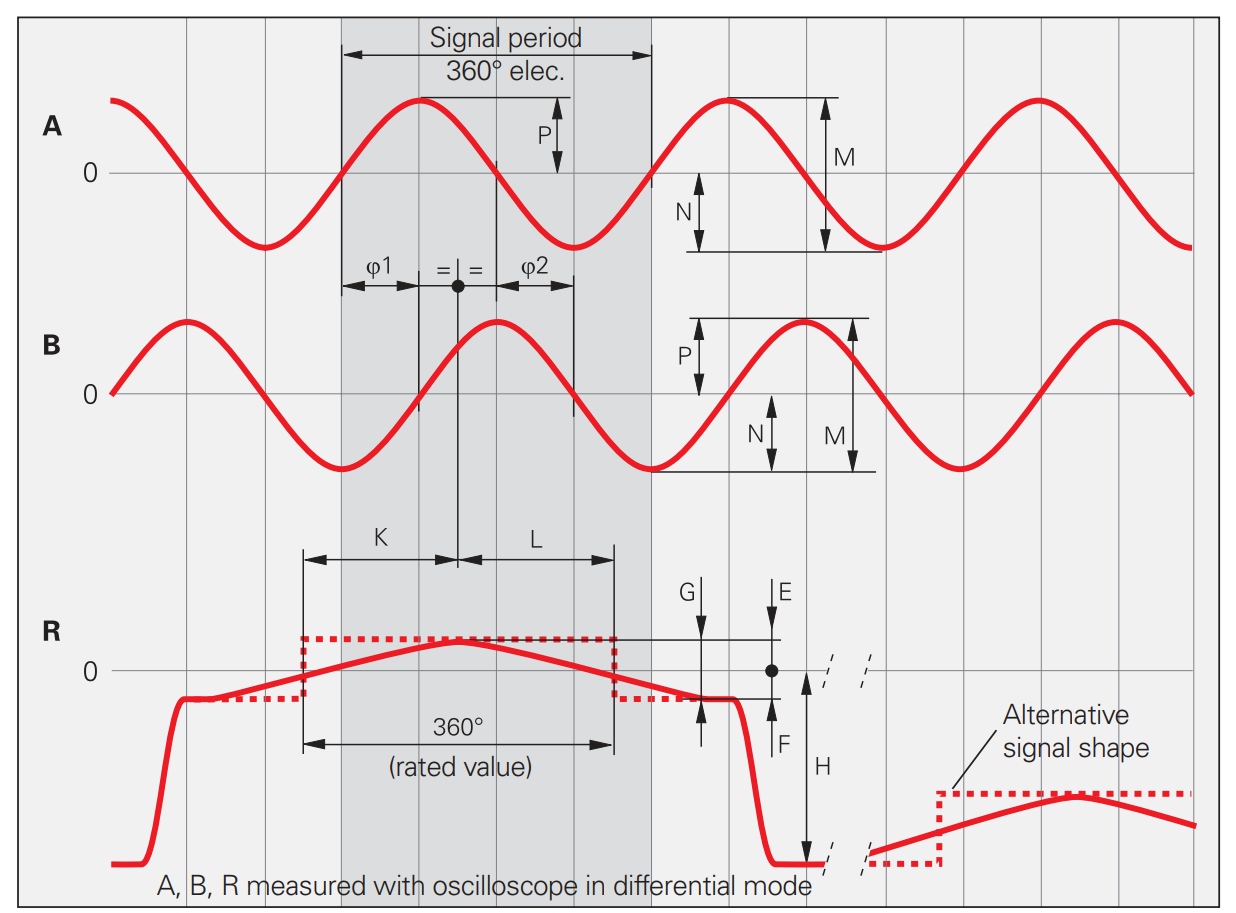

Well I have been researching the scales. It appears these scales LS486 are incremental scales 1Vpp output with a separate "R" output for reference position. It looks as though there is a reference pulse at each end 35mm from the full measuring length on one side and 70mm ish on the other, due to the reader position.
Someone here has already tackled these scales so i will post over on that thread and see how he went with them. linuxcnc scales index ref marks
This is the pin out on the schematic. I also found a pdf of the specs so that has helped. Not sure these can be a hard limits but can be used to home to set zero. It couldn't be to hard to add some hard wired limit proximity switches in as a safety?
The pulse on these sine/cos scales ref mark looks like it is only 0.5V, I am sure one of the input IO mesa boards said that the digital inputs could be set to something like 8bits resolution? hope I have the terminology right. So I should be able to program that pin to look for a set voltage difference to indicate zero etc? have I got that correct?
Thats enough for one post. Cheers Str8

Updating. I have purchased and received the 3 drive control modules for the Siemens 611 drives to convert from the Heidenhain interface to one that can do Analog inputs. I am assuming velocity control is the preffered method?
I have also tracked down a company in the US that makes a 1Vpp to TTL signal converter that can handle the linear scales input and also the 2 rotary encoders used for the table pivot and tilt feedback. Cost more than I would have liked but is much cheaper than new encoders. Realistically I think I may have been able to just run with out them and used the encoder feed back via the drives / servos. But they are there and may as well be utilised. The supplier sent this when I enquired.
"=11.0ptThe HEIDENHAIN LS 486C has a 20µm resolution glass which, as you correctly calculated, will produce a 10Khz signal at 12m/min. I have attached a data sheet showing the federate limits of each interpolation version for your reference. You can choose any interpolation option from 0.5x to 5x. The 5x interpolation model (SA 1872) will provide you with a 1µm TTL output signal. "
So that is the drive and encoder interface issues solved (yet to be implemented )
With the increasing global madness ongoing I am escalating my MESA purchases and any other overseas needs so I don't end up missing out. With that in mind I am at a loss for where to start. I have been reading the manuals on the MESA boards but like most newbies I have researched, I am still confused. My machine needs
