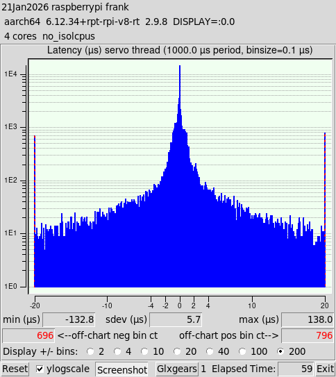

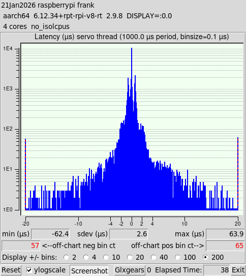

17 Apr 2026 19:23 #345651
by mclien
Replied by mclien on topic retrofitting a Proxon for coin die milling
Here are the 2 screenshots of the Pi. One whithout anything but the Desktop running, one with glxgears running (window resized to about the double).
17 Apr 2026 20:09 #345655
Replied by andypugh on topic retrofitting a Proxon for coin die milling
Pi5 might work better. But given that you have a 7i96 the Pi4 should work fine with the latency shown. (Just don't watch YouTube while milling)
