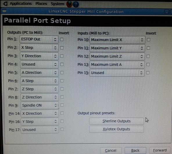

Hi All
I'm planning on building a plasma cutter, I've bought the control hardware and connected it up according to the destructions supplied. I get lights on the drivers, green ones to! and have LinuxCNC installed as a dedicated desktop.
The hardware I have is all UK sourced as a "kit" from Zapp Automation, who were ruoured to be "very helpful" but my last reply was a line saying "we don't use LinucCNC" which is less then great!

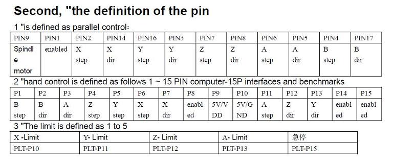

The paperwork give me this...(first attachment)
My settings in Step conf are...(second attachment)
I'm unsure of pin 1 (there is no "enabled"), pin 9 (no "spindle motor" - is this the spindle for a router? do I need it for plasma), pin 4 & 17 (no "B" option - would "B" appear if I set it for a 5 axis board?),
WRT the second table, is that for use with the "joystick" type manual control - a totally separate connector?

13 May 2013 18:44 #33987 by BigJohnT
Replied by BigJohnT on topic Newbie from the UK need a little assistance
Set pin 1 to Amplifier Enable.
Stepconf Wizard only supports 4 axis but that can be added later. Just leave those pins set to unused.
Test this axis will not work if your BOB or drive needs an enable line, in that case just open up Axis and test from there.
The spindle out will be used to turn your plasma torch on and off.
JT
