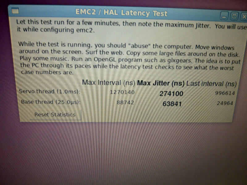

I run latency test and my Base thread : Max Jitter is 63841
So I'm going to fill in Stepper config wizard >Base Period Maximum Jitter 63841 but after I filled it then it change back to 50000 also up-button can not press.
LinuxCNC not except Max Jitter more than 50000? Can I just fill it 50000? Or anyway I can fill 63841?
Is the Servo thread will my issue? It is much value 274100. Since I'm going to use stepper motor machine.
I know mine is not so good number. But maybe I'd try to find another computer. Now that all I've got. Thinkpad T43
thank

If after 50 000 is is not recommended to use linuxcnc, it really does not matter to input 50 000 or 200 000.
wiki.linuxcnc.org/cgi-bin/wiki.pl?Latency-Test

The thinkpad T43 is a laptop, so never a good idea because of all the power saving stuff etc.
However this has come up before and I think this computer has a chipset affected by the SMI problem.
www.linuxcnc.org/index.php/french/forum/...-seconds-to-be-exact
You will need to be sure, do a lspci -vv, then compare the chipset to the list I put in the wiki
wiki.linuxcnc.org/cgi-bin/wiki.pl?FixingSMIIssues
Manufacturers use the same name for a model that often has different processors, MBs and chipsets through its life, so the name alone is not certain.
If you want to be certain that it is a spike not generally high latency do the rtai latency test and watch for periodic spikes
www.linuxcnc.org/index.php/english/forum...-the-latency-problem
Then follow the instructions in the first link if confirmed
The possible downside is overheating, you will need to carefully monitor this. Part of what SMI is about is monitoring processor temperature and switching the fan on and off or high or low dependent upon the figure.
On a desktop you can just jury rig the fan to be on all the time and forget it.
Might not be so easy on a laptop
Yes I've read that. Make sense that after 50000 is not recommended.
Also I can't input it more than 50000. So I guess coz it beyond the recommended range so I can't input it right? not a bug?
And I've read topic about SMI also and manage to decrease it to ~60,000. Before it is ~1xx,xxx that is all I've got from my T43.
