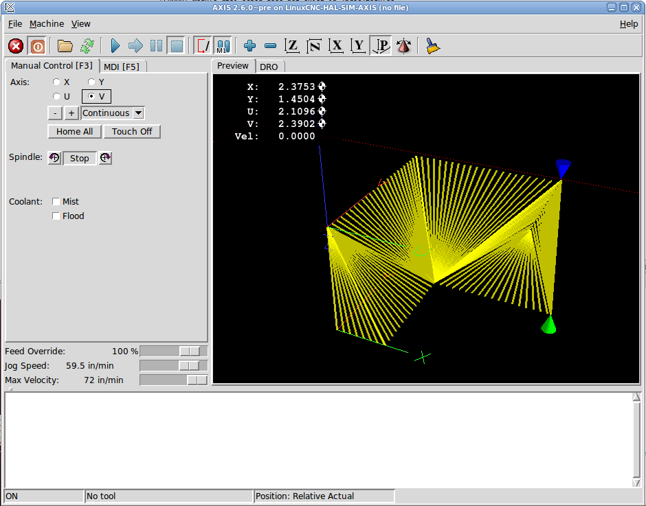

It's an XYUV machine.
You probably want to look at www.buildbot.linuxcnc.org and get the 2.6/master debs installed. Then you can have a live-plot like this:
(This is a sample config, sim/axis/axis-foam Looking at that will be a huge help with your own config, which I am afraid you are going to have to at least partly hand-code)
Replied by andypugh on topic stepper motors moving REALLY slowly, stepconf test
Is it worth pointing out at this stage that my machine is not an XYZA machine so much as a WXYZ or whatever the correct description would be for a 2x2axis machine?

Dear Andy
Yes, indeed, that looks exactly right for me!

I that case, you should be able to run the sim/axis-foam demo config and get a feel for how it works out for you.
What I think will work for you is to create an XYZ configuration (not paying much attention to Z) then manually copy the X and Y configuration stuff in the INI and HAL to U and V (you can reference the sim/axis-foam config to see how it all needs to fit together)
I think my system was already on version 2.6, according to the output from uname:
