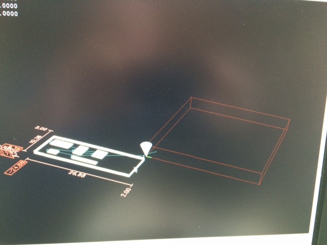

I am not sure what i did, i have attached the ini file, along with a pic, here is the question, i turn on the machine, home everything and then install a job, but i notice two things, the job is not within the boundries of the table, I tried reseting and home again, then used the touch off ,but it is still out of the boundries on the screen. See picture. Second thing is I noticed the red line is the boundries of the the table, but the measurments next to the red lines do not add up to what are in my config settings. I am sure this is something i overlooked and any input I would appreciate it.

Your program coordinates are mostly negative and you probably are making a zero (touch off) on your machine zero.
You can do two things:
1) Generate another GCode with positive coordinates
or
2) make a touch off in a position on your table that the part can fit it.
or

so one last question, you can not see it in the picture, but i noticed prior to downloading the job, the table (in red) has measurements next to it, these measurements do not add up to what I have in the config file, is there a reason why?

I figured it out, thanks for the help again
