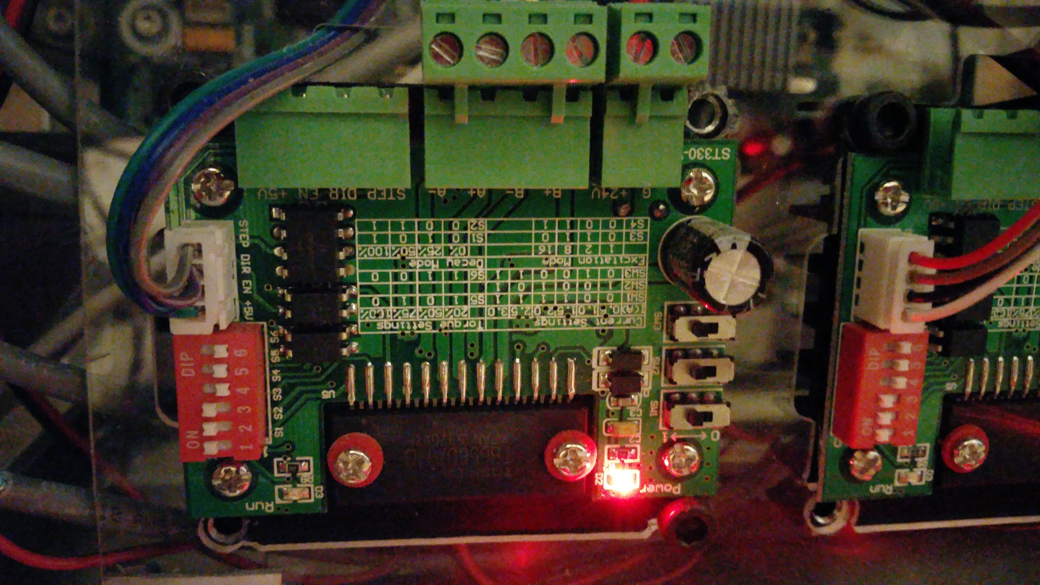

Greetings all, i'm new to the forums but not totally new to the hobby CnC world. I have had my X-Carve for a little over a year now and with the advise of my friends have moved from an Arduino motion controller configuration to LinuxCNC. I have afew things left to get fully functional but i am currently trying to tune the machine. all the steppers are jogging (more or less**) e-stop works, touch off probe is wired properly but haven't tested it in EMC.
here's where i'm running into issues.
when jogging at low speeds (ie. 10ipm) my machine sounds like a jack hammer, more on Y as there are 2 stepper motors. when i was using the Arduino setup this was not the case. i understand i'm using more amps now and this is an entirely different beast by comparison. but i dont think this sound or behavior is correct. i could be wrong but its making the machine jerk and shake which will equate to pore cut quality long term.

Machine configuration physical:
X-carve
acme screw Z
GT2 pulleys belts X-Y
Stepper Driver kit with BOB

Are you jogging with a jogwheel?
A jogwheel sends (in effect) square-wave position commands. These can be a bit harsh on a machine with high accelerations.
You could try reducing the accelleration, or you could pass the jogwheel counts through the ilowpass HAL component (which is intended for this)

What accelleration settings are you using? Is this a parallel port machine or are you using a step generator?
As a simple experiment, make the step-times 5 x longer. Then if that doesn't work make the accelleration 10s lower. You probably don't want to leave either setting that way, but it might help eliminate two possible sources of the problem.

1. Your X and Y acceleration are likely way too quick (you have 200 IPS^2 which is greater than 1/2G)
this means you get to full speed in about 1/250 of a second! Thats starting off with a bang!
I would start initial acceleration at no more than 10 times the maximum velocity
2. Your base thread is quite slow (16 KHz or so) this is liable to make step generation a bit crunchy
I would see if you can improve your PCs latency so you can raise the base thread rate

i'm basing my base jitter around the maximum wich is about 50k. this is the best PC i have to throw at this thing at the moment. but if there are things i can do to help reduce my lag i'd love to hear them
thanks in advance.
