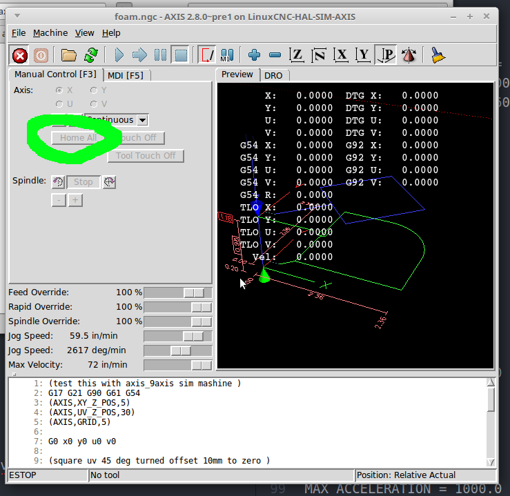

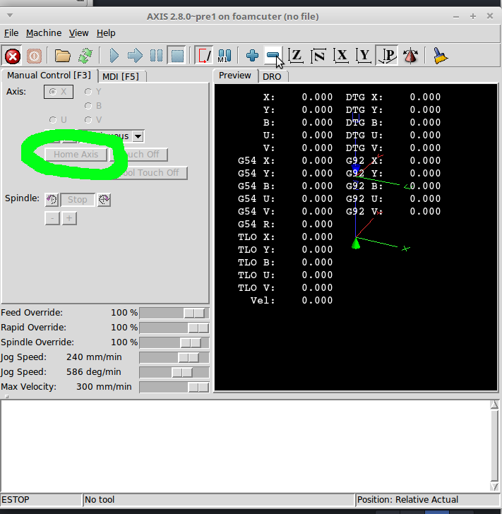

The example foam cutter configuration has "home all" button, while my configuration has "home axis". I would like to have both if possible or just "home all". How to do it?

Do you have homing sensors assigned to every axis? You also need a homing sequence defined for each. I believe you need to set the HOME SEARCH VELOCITY to zero if you want to have an axis ignored.

I do not have homing sensors. Thanks to your hint I was able to solve the problem by adding lines to the ini file:
HOME_SEARCH_VEL = 0
HOME_SEQUENCE = 0
HOME_SEARCH_VEL = 0
HOME_SEQUENCE = 0
