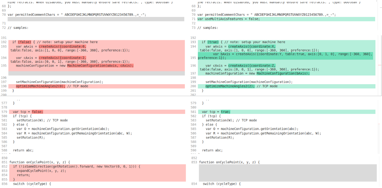

So i have changed .ini and .hal files with your instructions, Linuxcnc works, starts the code, B axis rotates, and afters that i got joint error. Every time other command number, whatever it is.
I put reworked config and the gcode file in attachments. I am not sure, if the axis is a problem, or the coordinates after rotation. Maybe my postprocessor needs rework also? I put it in attachments also. It's a deafult LinuxCNC code with slight adjustment done by my friend. I can ask, what was the changes if it's needed.
EDIT: I ran diff_test for both postprocessors, left is deafult, right is mod i use:
