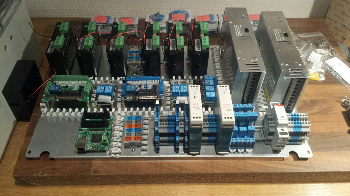

11 Apr 2019 12:38 #130659
by pl7i92
Replied by pl7i92 on topic This is an example of what I am trying to accomplish :
you may post a image of your setup and a image of the mashine Coordinates you like to move
hardware used like i did in my upper post
so we here can give you a real good start
