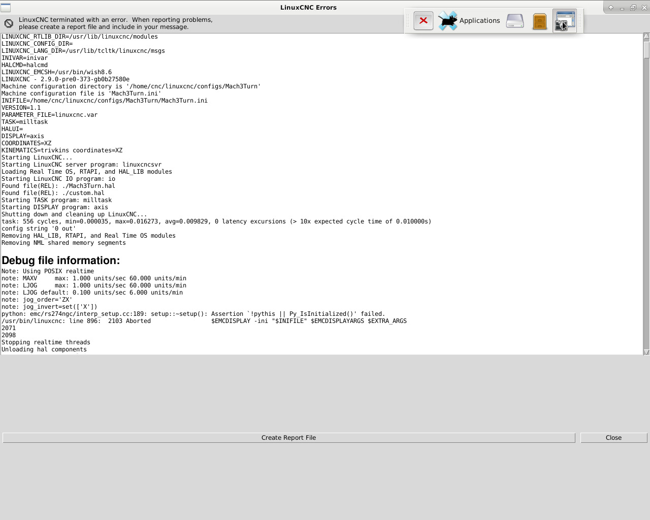

I do have a problem with the 2.9 version in that when linuxcnc closes it give an error message
I think I have read about this before . but I cannot find the cure.

The closing issue is fixed in the later versions of Linuxcnc, just upgrade to a new build.
