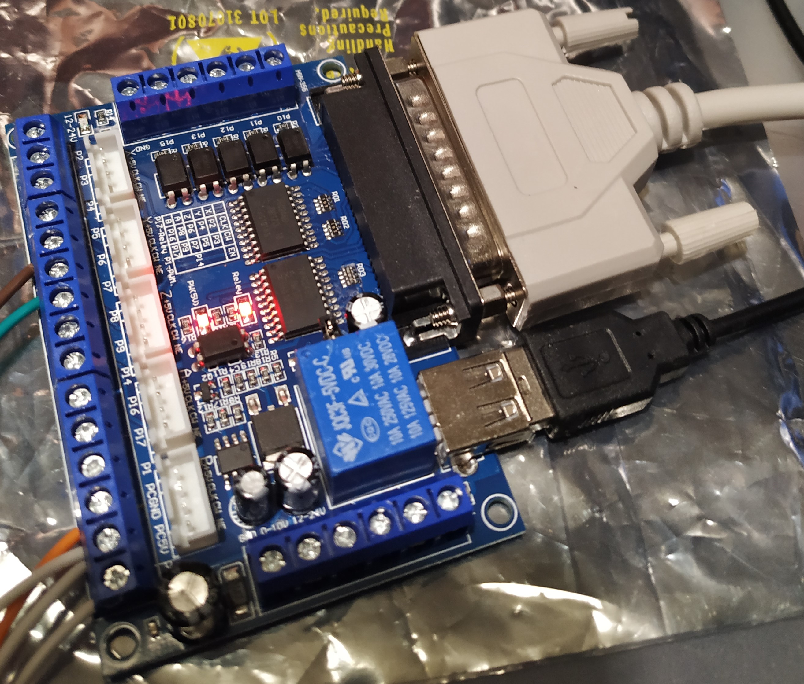

5 axis baord screenshots of stepconf for it please? was created by gzcwnk
Hi, this is apparently a common BoB used in LinuxCNC does anyone have the config shots for stepconf please? I have tried a few times but am unable to make it go.
- Thank you received: 4654
06 May 2020 12:09 #166868
Replied by andypugh on topic 5 axis baord screenshots of stepconf for it please?
Use a step time of 5000nS.
If that doesn't help, try inverting the step pulse in stepconf.
