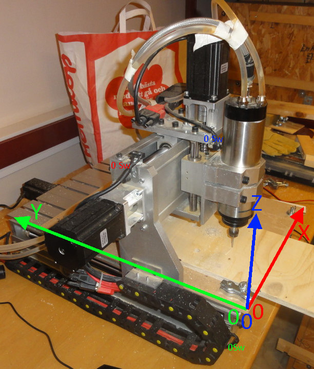

I have finally started to work with LinuxCNC
Tried using the Mach import feature in LinuxCNC but it didn't work very well for me, but I was fortunate enough to have both systems' monitors on the same shelf side by side which resulted in a nearly working LinuxCNC system.
The LinuxCNC system is able to run the home-all routine, but I find that the Z axis goes in the wrong direction, so after home-all I need to enter a positive value (G0 Z10) to get the tool to move towards the workpiece.
This is wrong in my mind, as it should be a negative value like: G0 Z10.
I find that the X and Y axes work as I thought, it is only Z I have problems with.
What do you think is the error?

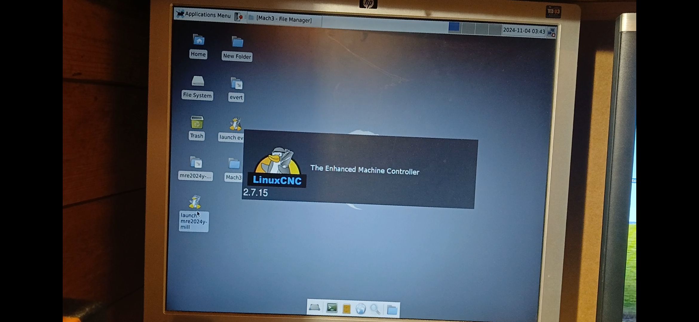

I hope this will be the file that was requested
This is my LinuxCNC version:
Edit ---

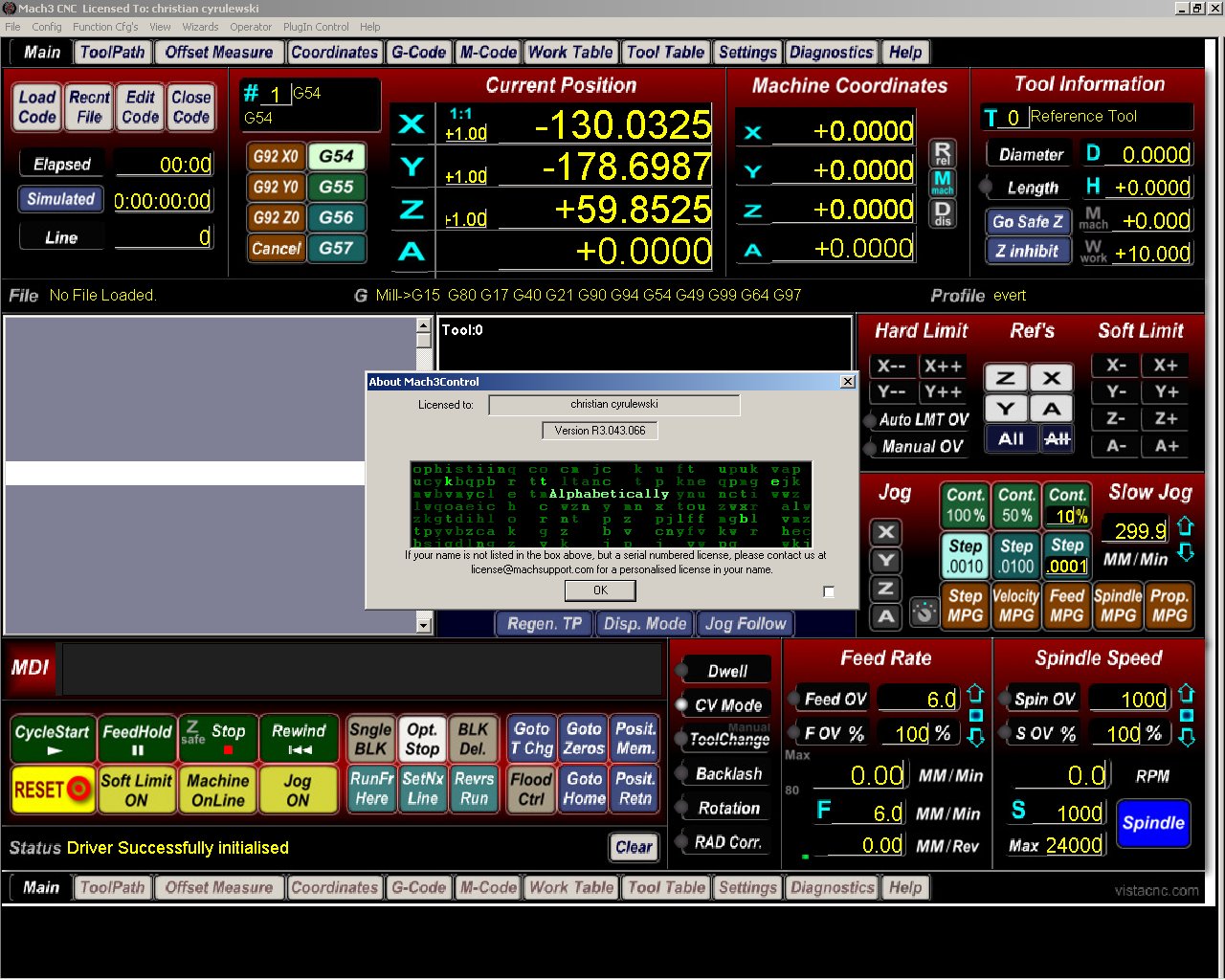

This is my Mach3 version:
and XML file:
Edit ---
and XML file:

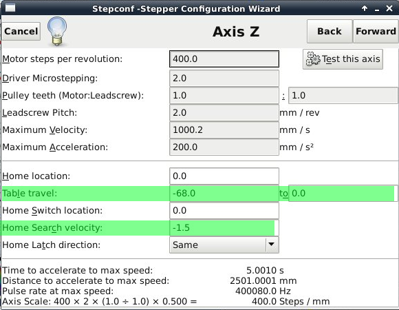

In your ini [AXIS_2] section change these lines:
to
SCALE = 400.0
HOME_SEARCH_VEL = 1.500000
HOME_LATCH_VEL = 1.250000to
SCALE = -400.0
HOME_SEARCH_VEL = -1.500000
HOME_LATCH_VEL = -1.250000Please Log in or Create an account to join the conversation.

04 Nov 2024 18:11 #313766
by lgrfbs
Replied by lgrfbs on topic Z axis goes in the wrong direction, so after home-all

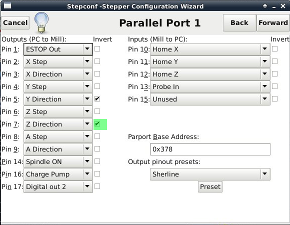

- lgrfbs
- Posts: 13
09 Nov 2024 23:40 #314156
by lgrfbs
