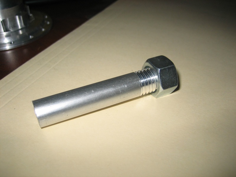

02 Feb 2011 04:35 - 02 Feb 2011 04:37 #6952 by rkappius
Got it to work. All I had to do was issue a speed command, which was in the threading.ngc example code.
Hacking that code to cut a 1/2"-13 thread I got the attached.
Finally ready to get back to real prototyping.
