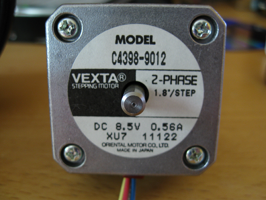

please forgive the thread-jack but this is the only place i can find any search hits on the Vexta C4398-9012 stepper motor.
I have 3 of these motors (see attached image), that I picked up from surplus cheap. I'm looking for driver information. I called Oriental Motors and all they could tell me was that it was a custom make for Intermec (guessing for a barcode label printer).
this motor has four wires, yellow, red, white and blue. the label says
2-Phase,
1.8 degree/step,
dc 8.5v, 0.56A
Xu7 11122
My hopes are to make a dremel mini cnc for drilling pcb's. I could sure use some pointers. TIA.
2-Phase,
1.8 degree/step,
dc 8.5v, 0.56A
Xu7 11122
