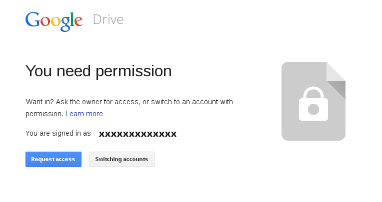

03 Nov 2014 00:11 #52695
by midworld08
Replied by midworld08 on topic NCBox CF Booting Solved.
Here is a link to a Google drive folder.
drive.google.com/folderview?id=0By16u16K...QZlVwRUU&usp=sharing
Anyone with the link can access the folder, and download the image. Its a 1.6G gzip of a dd.
I have tested the image onto another CF card, and it booted no problems.
The image contains Kernel 2.6.30, compiled for the NCbox, Vortex CPU. It also contains a rip install of Linux CNC 2.7, without the USB support. This version is set up so that it connects to the old repositories so that synaptic works seemlessly on updating and installing, along with apt-get. It also has LXDE and a few other window managers to help make things run a bit faster. It defaults to gnome however.
I'll be adding another image soon, of the standard 2.6 version of Linux CNC, which is not rip install. Will send an update when this is done.
If you check the folder and the file is not there yet, please give it a day to upload. I've only just set it going.
The following user(s) said Thank You: ArcEye, tkamsker

- ArcEye
- Posts: 25
- Thank you received: 758
03 Nov 2014 00:49 #52697
by ArcEye
I can get the url but the folder is not unlocked
I clicked on the request access button, but no idea what you will receive.
Replied by ArcEye on topic NCBox CF Booting Solved.
