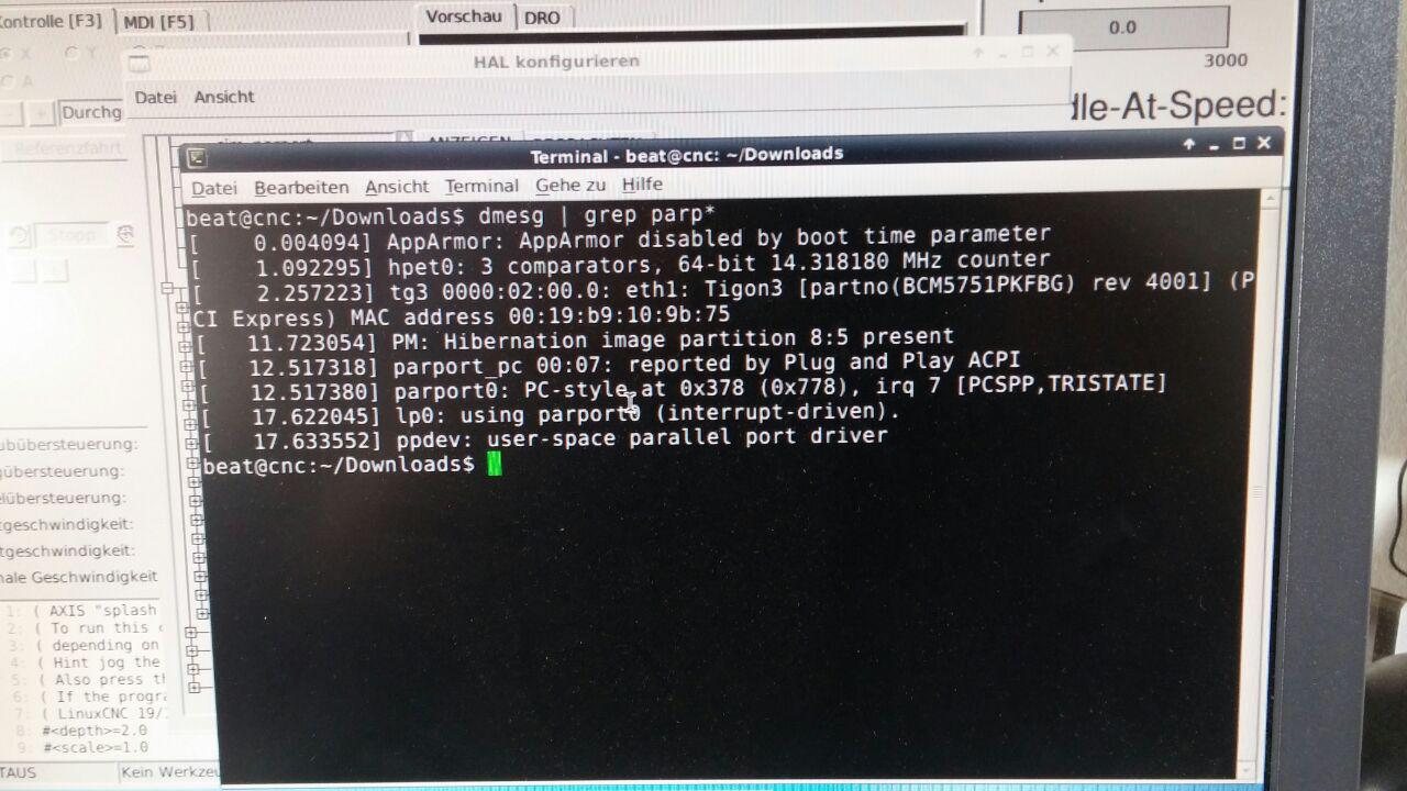

use
dmesg | grep parp*
to detect the correct parport adress
it seams to be the wrong one

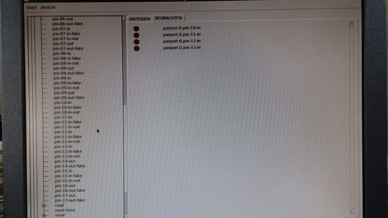

then use HALshow
in mashine menue
(watch List( select
parport.0 pins to be watcht
dmesg | grep parp*
then use HALshow
in mashine menue
(watch List( select

Address 0x378.
What's the address 0x778 ?
HAL show Pin 10-13 no action.

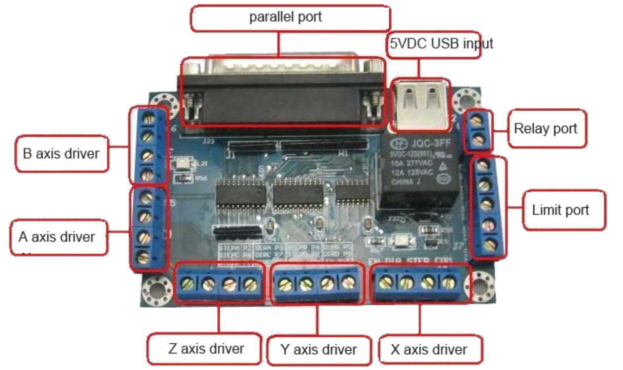

can you tell how the Switches are connected
GND 5V BOB -> Switch -> Limit_in
this is the Correct Wirering

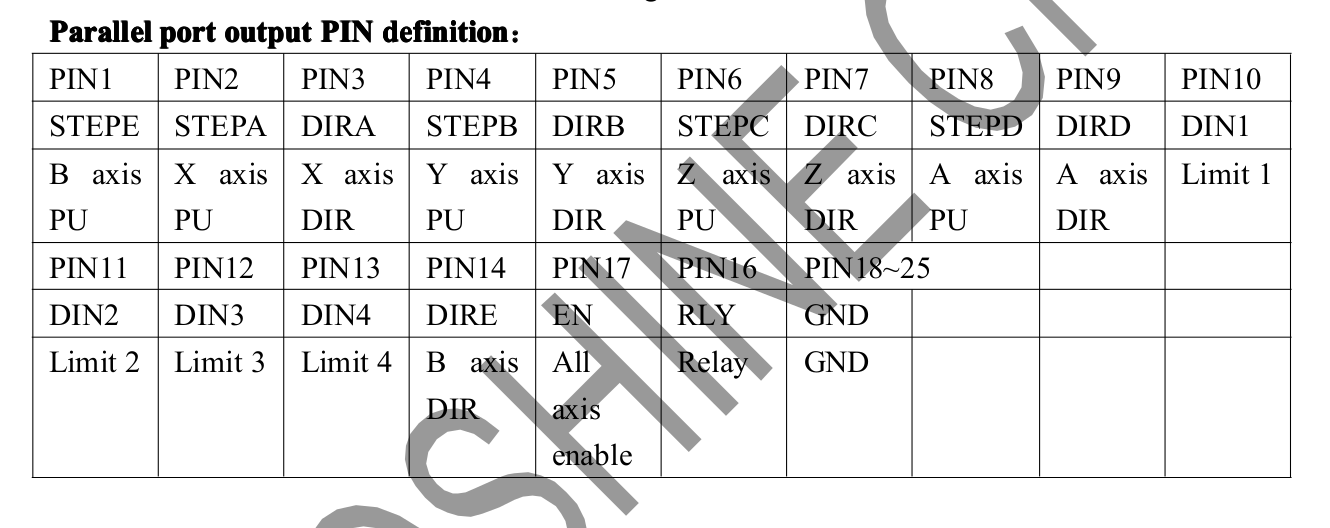

I connect switch 1 (NC) to GND and Limit port 1.
Switch 2 GND and Limit port 2.
And so on.
And so on.

There are so many Fake and dummy Boards out
THE Blue Ones
I Hope You dident catch a Fake one with no Inputs working at all
AS You did the Wirering right and you got no signal
PLEASE Check im COM from the AXIS are the SAME as COM from the Limit
THE Blue Ones
