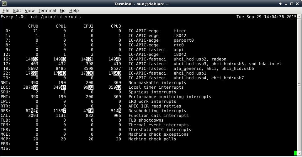

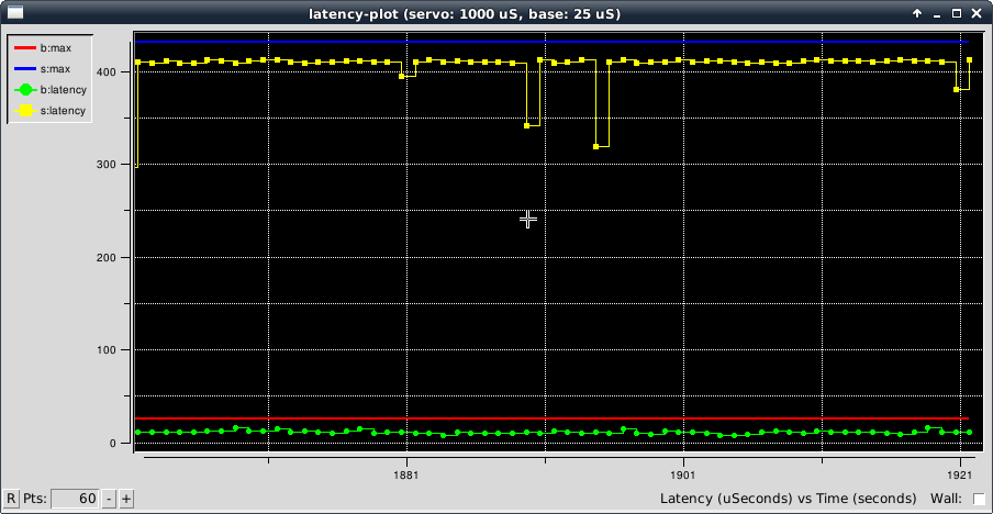

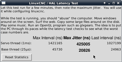

So I've been trying to make the switch from Mach3 to LinuxCNC (due to having some issues with my spindle stopping for no apparent reason and losing steps, which may or may not have anything to do with Mach3) and as it turns out, my computer is absolutely terrible when it comes to latency. I've spent the better part of 2 days reading the various troubleshooting guides and have done most of what there is to do (turning off everything it the BIOS, isolcpus=1,2,3 in GRUB2, putting in a PCI based graphics card) and still the latency is off the chart, though I have gone from 800us+ jitter to 400us+ jitter from these efforts. It's not even in the ballpark, leading me to believe this is a hopeless case or something obvious is out of kilter.
Before I just move on and put together a new controller computer based on hardware that is known to work, I'm wondering if anyone else has gotten such atrocious performance and are there any low hanging fruit I might have overlooked?
Hardware: Dell Optiplex 755, I5 4 core 2.4Ghz, 2GB ram, 500GB HDD (80GB for linux, dual boot with windows vista) Asus HD 5450 Silent graphics card (added to see in onboard graphics was causing the problem.)
Screenshots attached.
Thanks!

30 Sep 2015 20:31 #63263 by andypugh
I was wondering about SMI, but your plot seems to show a constant high latency, rather than the regular spike caused by SMI.
30 Sep 2015 22:25 #63273 by cncnomad
I have not tried the SMI mod, mostly because as you note the latency is constant rather than periodic, and the mod seems to involve compiling kernals and such, which is a bit more complex an undertaking than I cared to take given the symptoms. Something major is interrupting the hell out of the CPU and I can't figure out what. I suspect I can even see it scrolling down web pages in a browser, in the form of horizontal graphical glitches in the video as I scroll (or at least I'm guessing it's related.)

30 Sep 2015 23:02 #63284 by Todd Zuercher
Replied by Todd Zuercher on topic Before I throw this computer in the garbage....
One of the pictures you posted show 4 cores? but I'm pretty sure that is a 2 core CPU, are you sure you remember to disable hyper-threading in the Bios?
