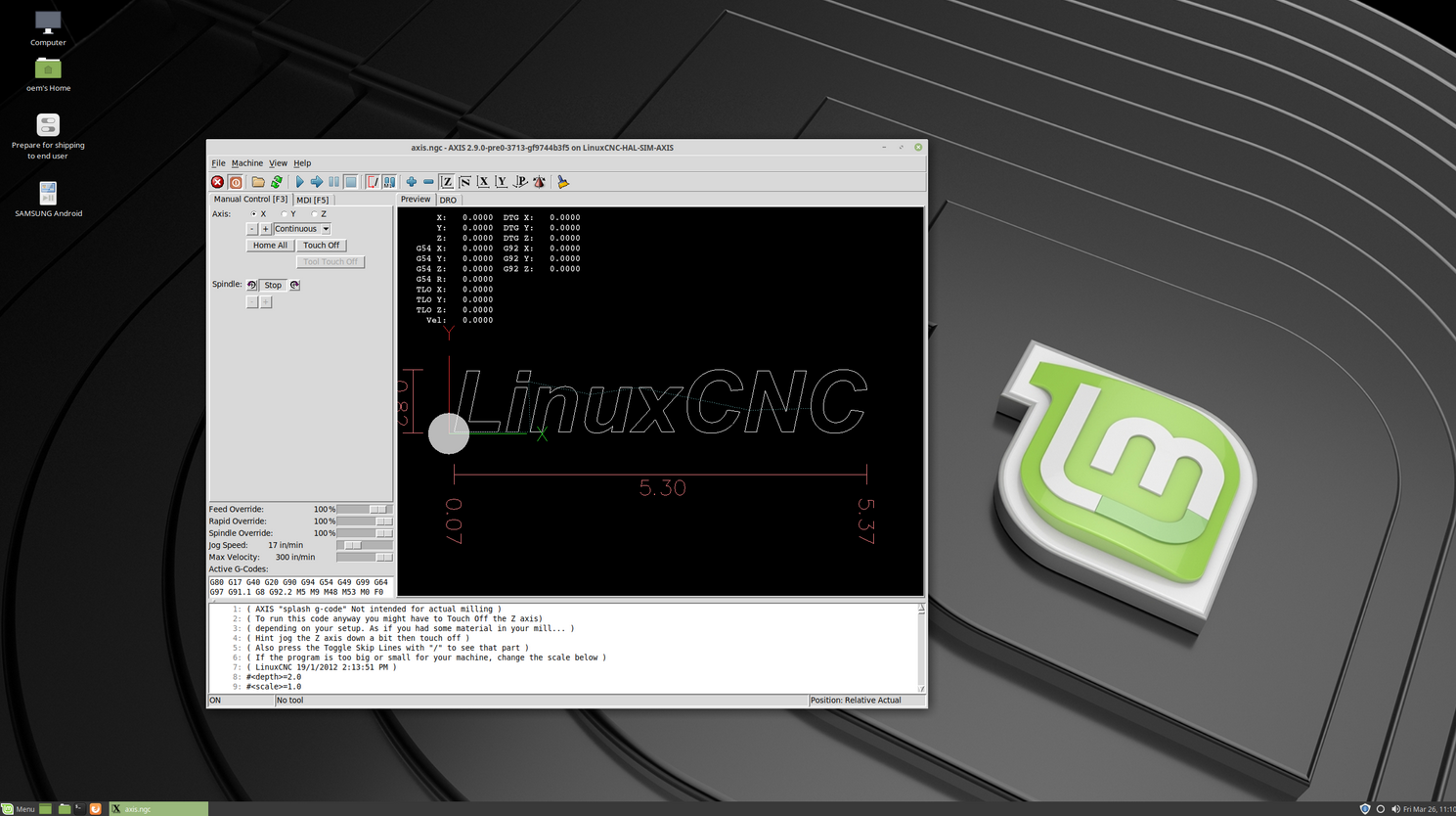

Linux-Mint-5.11.4 rt Stormhold edition.
Pre-installed
- Linux mint 64 bit
- Linuxcnc
- Linuxcnc-dev
- Ethercat-master
- Linuxcnc-ethercat
Extra's
- Parport kernel drivers
Feature's
- Set's mac adress at boot time
- Start's ethercat bus at boot time
Spec's
64 bit, 3Gb
Installation
- When usb or dvd boot's, hit a key within 10 sec. Install OEM version.

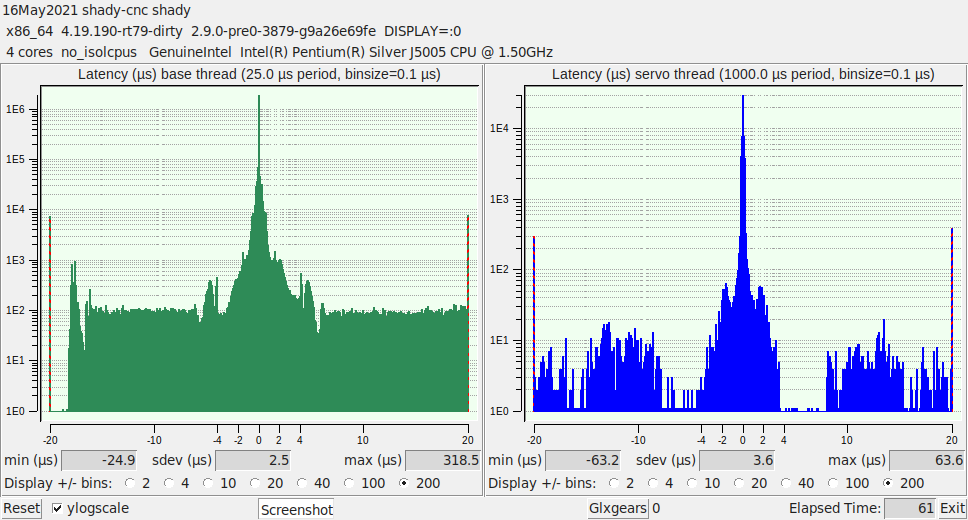

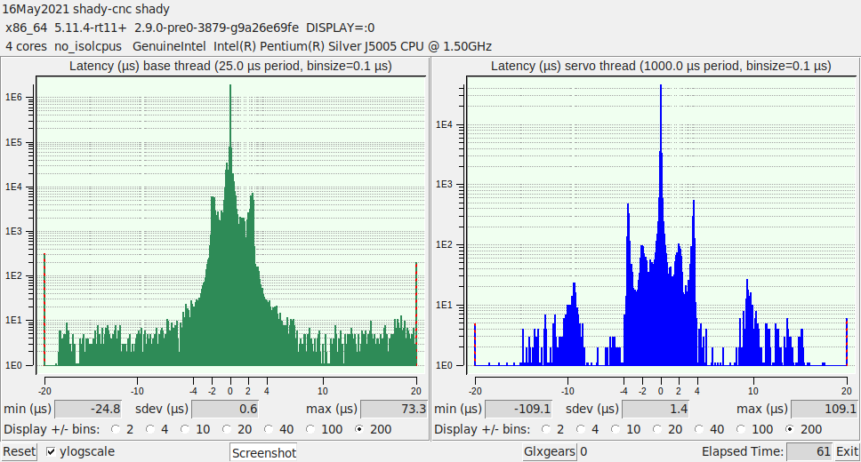

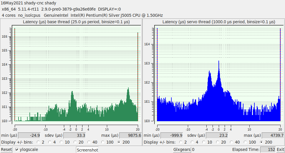

Dear Grotius,
I am sorry but I don't really understand a few things about the kernel image which
was provided as part of the Linux-Mint-Rtos-Stormhold-5.11.4
I installed with grub and after I compiled new versions of the kernel I can now compare both the version that you provided and the one which I compiled
but using the latency-histogram of the Mar25 compilation doesn't seem to be RT to me.. or at least not the fully preemptible version.
xx@xx-cnc:~$ uname -a
Linux xx-cnc 5.11.4-rt11 #1 SMP Thu Mar 25 13:15:14 UTC 2021 x86_64 x86_64 x86_64 GNU/Linux
- latency-histogram screen shot 16May2021-152
compared to the RT11+ I did compile as fully preemptible:
Linux xx-cnc 5.11.4-rt11+ #2 SMP PREEMPT_RT Sat May 15 23:06:08 CEST 2021 x86_64 x86_64 x86_64 GNU/Linux
But that is not all, I have tried with and without wireless but all my versions of the kernel with RT+ which I did (not sure why I do get a + sign) seem to make the GUI super slow (think 1 refresh every second when I move a window with the mouse), barely usable.
But I do get much better histogram tests. (see attachement screenshot)
With your kernel the GUI is behaving fine...
So it seems I only do get RT performance in the latency-histogram when the GUI is super slow
I checked the internet and I don't see anyone complaining on RT on the J5005 I did get one error in the dmesg though:
Also I need to add the mac address for the ethercat still
My experiments compiling RT Preempt on the raspberry 4 were not having such a slowing down effect so I wonder what can be wrong and also why is the kernel from 5.11.4RT not really having RT performance? (what was your config?)

Dear Grotius,
I will summarise what I observed
1. Kernel 5.11.4 RT which came with image
- not RT
- no wifi
- GUI fast
2. kernel 5.11.4 RT + which I compiled
- RT
- wifi
- GUI super slow
3. kernel 4.19.190 RT
- RT OK
- wifi OK
- GUI OK
- no ethercat because it is an old kernel and ethercat from the image wasn't built against it.
