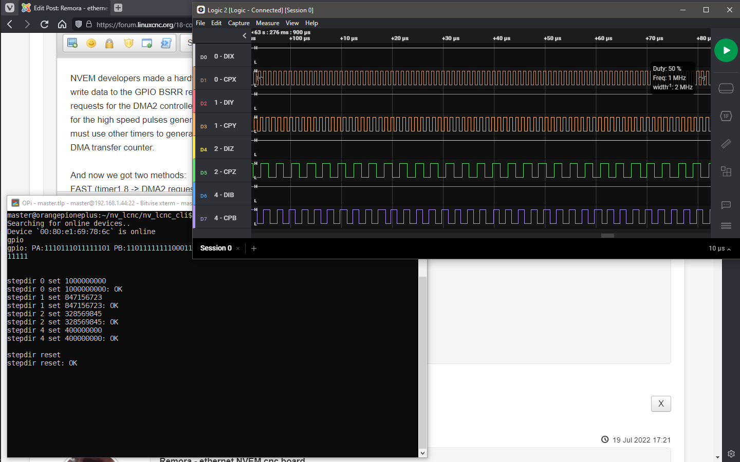

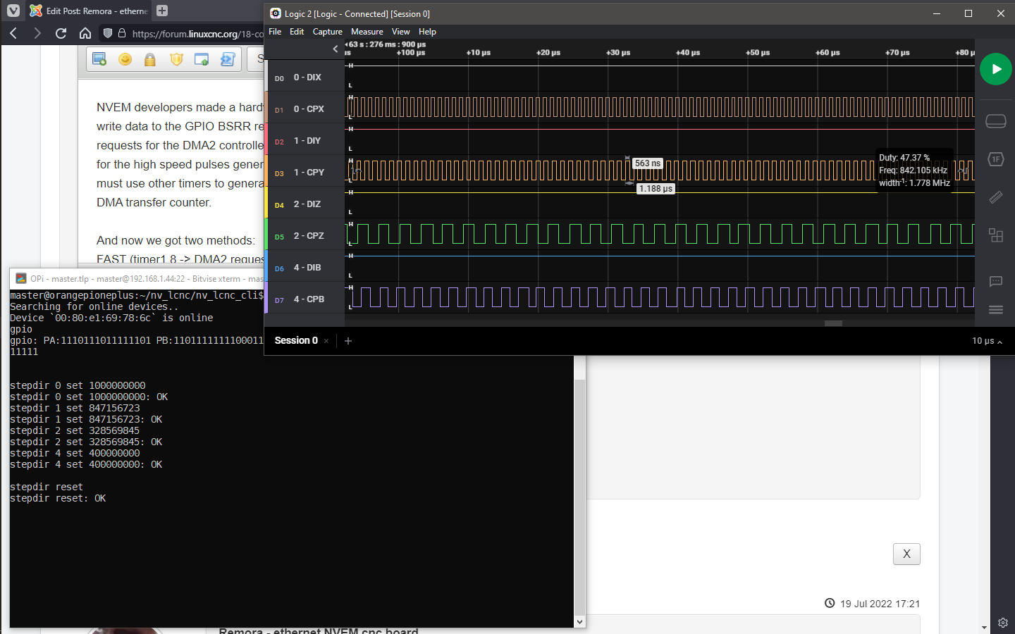

Currently I'm working on my own Ethernet controller (two stm32 black pills and a couple of cheap modules). And when I started a firmware part, I found an old project (firmware + LinuxCNC driver) of mine for the NVEM controller. This project can make a stable 200 KHz output for all 6 axes. I decided to deep into firmware to find out a new methods for the steps output. After a few weeks of testing I found two new methods and combined them into new firmware stepgen module. And now stepgen can outputing steps at 1 MHz rates (for the XY axes) and at 400 KHz rate (for the ZABC axes).

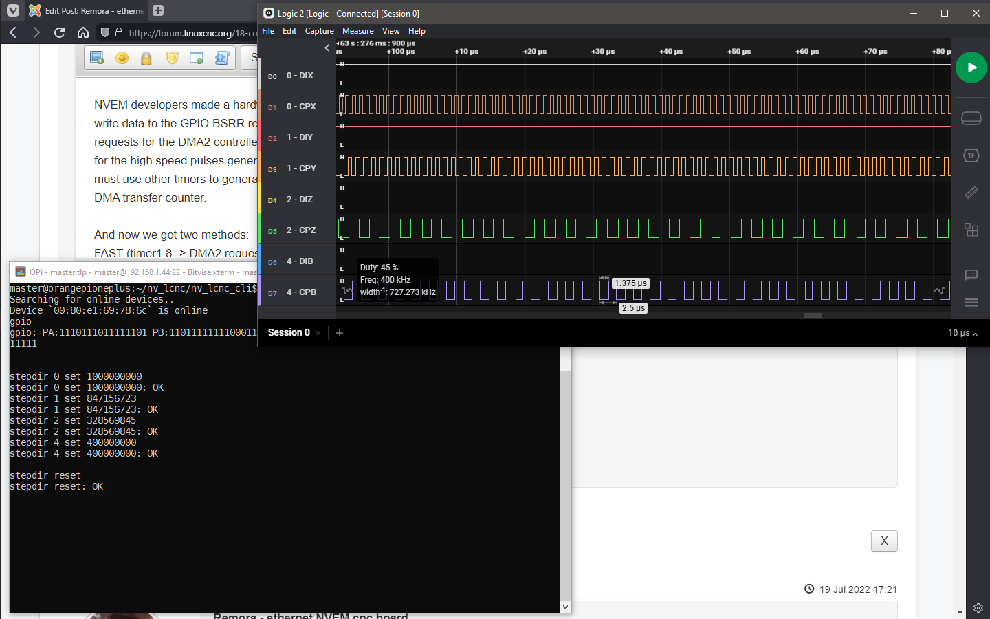

NVEM developers made a hardware planning mistake, so we can't output pulses directly using STM's timers. But yea, we can use timers + DMA to write data to the GPIO BSRR registers. One problem here - we can use only timer 1 and 8 to do the trick because only those timers has a transfer requests for the DMA2 controller. DMA1 controller has no access to the GPIO BSRR registers. So after a first look we have just 2 stepdir channels for the high speed pulses generation. After second look I found out that we can use timer 1 and 8 for the other stepdir channels too. To do that we must use other timers to generate softly (inside IRQ handler) unused DMA transfer requests for the timer 1 and 8. As a pulses counter we using DMA transfer counter.
And now we got two methods:
FAST (timer1,8 -> DMA2 request -> DMA2 stream -> GPIO BSRR) - up to 1 MHz of pulses;
SLOW (timer3,4,6,7 -> IRQ handler -> DMA2 request -> DMA2 stream -> GPIO BSRR) - up to 400 KHz of pulses.
I can't show the sources because I'm using some parts of the code for the business. But this short description will help to understand the tricks.
Last edit: 19 Jul 2022 12:40 by MX_Master. Reason: + screenshots

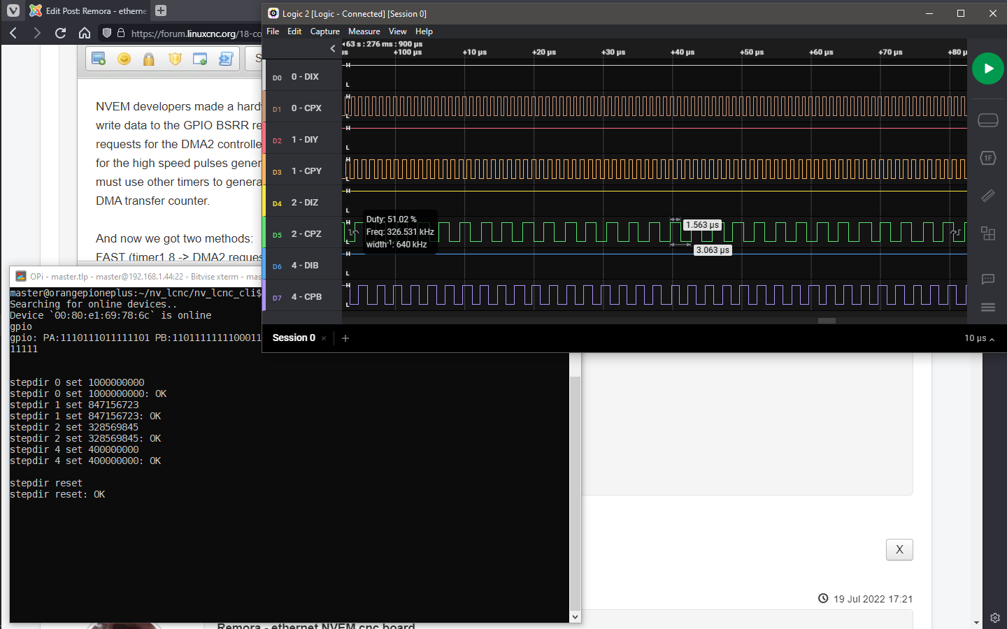

19 Jul 2022 22:46 #247796
by scotta
I see a slight difference in the requested frequency and the output. Is this due to the underlying DMA frequency or because it is a digitally synthesised frequency?
Thanks MX_master! Shame your code is not open source but enough pointers to get me thinking. I'm guessing you are using a ring buffer or similar to hold the step pattern?NVEM developers made a hardware planning mistake, so we can't output pulses directly using STM's timers. But yea, we can use timers + DMA to write data to the GPIO BSRR registers. One problem here - we can use only timer 1 and 8 to do the trick because only those timers has a transfer requests for the DMA2 controller. DMA1 controller has no access to the GPIO BSRR registers. So after a first look we have just 2 stepdir channels for the high speed pulses generation. After second look I found out that we can use timer 1 and 8 for the other stepdir channels too. To do that we must use other timers to generate softly (inside IRQ handler) unused DMA transfer requests for the timer 1 and 8. As a pulses counter we using DMA transfer counter.
