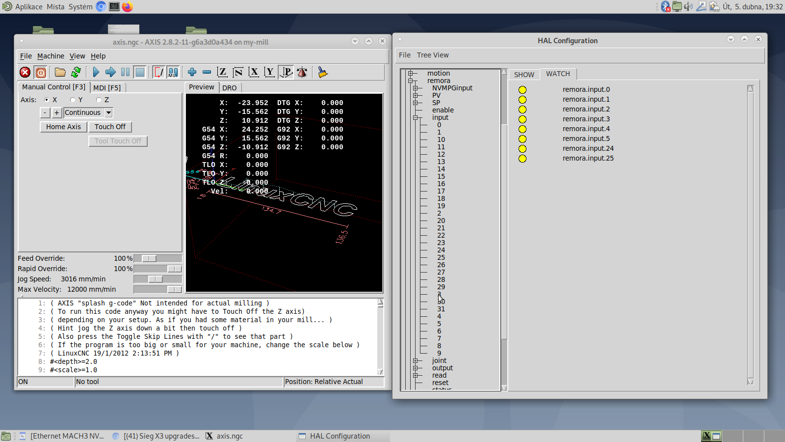

05 Apr 2022 20:14 #239378
by Domi
Replied by Domi on topic Remora - ethernet NVEM / EC300 / EC500 cnc board
Hello. Does anyone have anything new? I just looked at the input pins
via Hal Configurate / watch which I have involved. But I don't know how he went on to write Hal and Ini.
Input pin 0: Estop
1: Probe
2: Proximty sensor. For example, X
3: Y
4: Z
5: Probe Alarm
And then when the 3D touch comes on In6. And I don't know how to turn it on and test the relay outputs. And pins 24 and 25 are still on, but I don't know what they mean.
Input pin 0: Estop
1: Probe
3: Y
4: Z
5: Probe Alarm

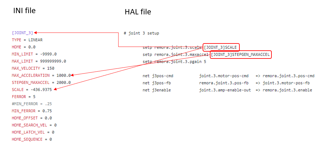

- cakeslob
- Posts: 927
- Thank you received: 280
06 Apr 2022 00:41 #239407
by cakeslob
Replied by cakeslob on topic Remora - ethernet NVEM / EC300 / EC500 cnc board
Hey domi, it looks like you have the hardware stuff working, so now its mostly configuration, which is more linuxcnc than specific to remora. This will require more reading into general linuxcnc concepts.
Have a read into the hal basics
linuxcnc.org/docs/stable/html/hal/basic-hal.html
and the remora specific hal documents
remora-docs.readthedocs.io/en/latest/sof...dstops-home-switches
Can you upload your configuration files? or are you just using this one ? github.com/scottalford75/Remora/tree/fea...igSamples/remora-eth
- Domi
- Posts: 64
06 Apr 2022 06:16 #239415
by Domi
Well thank you. I will study. So only work in the remora-eth.hal file so far? And I will rewrite my pins in the files of remora halls?
