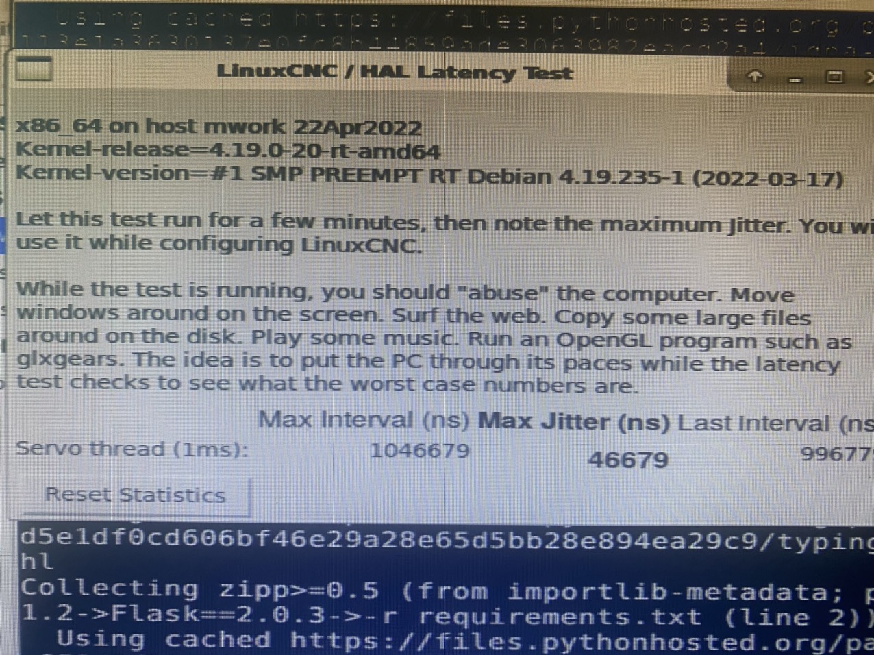

hi all,
I have a 7i80db16 mesa board.
And I'm using Celeron J1900 2Ghz.
My latency test:
Servo thread: max Jitter: 50000(ns)
base thread(25us) max Jitter 143648(ns)
is This good to run linuxcnc?
Any Bios setting to improve Jitter?
thank you so much

21 Apr 2022 14:09 #240800
Replied by tommylight on topic Latency- Test
Seems OK, but to know for sure, connect the card to the PC and leave it on for a day or two or more.

Replied by andypugh on topic Latency- Test
If you are going to use a 7i80 then run the latency test without the base thread.
latency-test 1000000

22 Apr 2022 07:54 - 22 Apr 2022 08:03 #240860
by nhanpham
Replied by nhanpham on topic Latency- Test
i got :
Servo thread(1ms) : max interal 1046679 and max jitter : 46679
with this jitter, can my system work normally?
thank you
thank you
Yes, that is perfectly acceptable.
