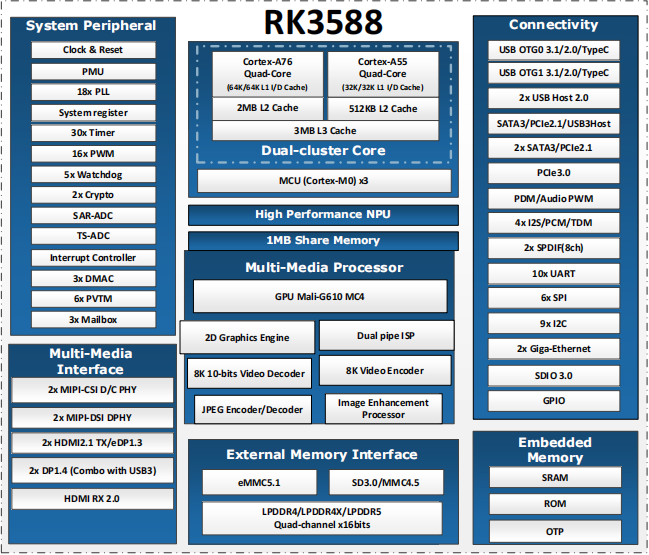

I've been following on and off since the project started. Is there an updated wiki or sticky post with the latest overview of the hardware and Remora firmware to grab? I was actually wondering today what the max jitter may be on the servo threads with Remora.
Where does a noob go to get an overview of the latest state of things?
forum.linuxcnc.org/18-computer/48079-can...nfigured-to-run-lcnc shows the progress of getting LCNC with a RT kernel for RK3588 boards. If we get specs to the three integrated Cortex M0 micro's we might be able to use Remora for an all-in-one board with LCNC.
AllwinCNC is another example allwincnc.github.io/index.html

I haven't seen a doc yet that covers how the Cortex M0's are connected internally or any register info for them.

I was also wondering how many accessible pins are connected/accessible to the M0, I dont know if it dedicates specific pins on not, that could be an issue

The Pine QuartzPro64 devs mentioned the Cortex M0 are in their docs. I haven't found them yet.
Have to see about how the IO's are shared.
The good thing is that there is u-boot source.

The docs are secretly hidden here: (so don't tell anyone)
github.com/Hao-boyan/rk3588-TRM-and-Datasheet

the RK3588 is a very powerful chip. It requires careful PCB design and hence not easy to replicate.
In my opinion it would make more sense to port remora to other architectures, like the CH32V307, also mentioned in cnc-club.ru:
www.cnc-club.ru/forum/viewtopic.php?f=15...74b124058&start=1360

The CH32V307 is a MCU, the rk3588 is a SOC that contains 8x cpu and 3x M0 MCU. The reason to port remora for the M0 cpu is so you would only need a SBC with that rk3588 chip.
As you could see in the other thread, the Orange Pi 5 with the low latency kernel has a low latency, about 6uS on the base thread, so even without using the mcu it's usable. With Remora on the MCU it might even improve further. But it's the question if the MCUs aren't already in use for other tasks. As far as I could see there is one MCU programmable, not sure if this mcu is powerfull enough to improve over the cpu.
If you want to build your own board, why not use a stm32 where Remora is build for?

Even if you get the internal cortex-m0s to cooperate (assuming they are not used by the firmware for power management and related system management stuff) you still need a RK3588 board that has enough accessible I/O Pins. Then you need a breakout board. On the breakout board you could easily include a ~1US$ microcontroller, talk SPI to it and be done.
