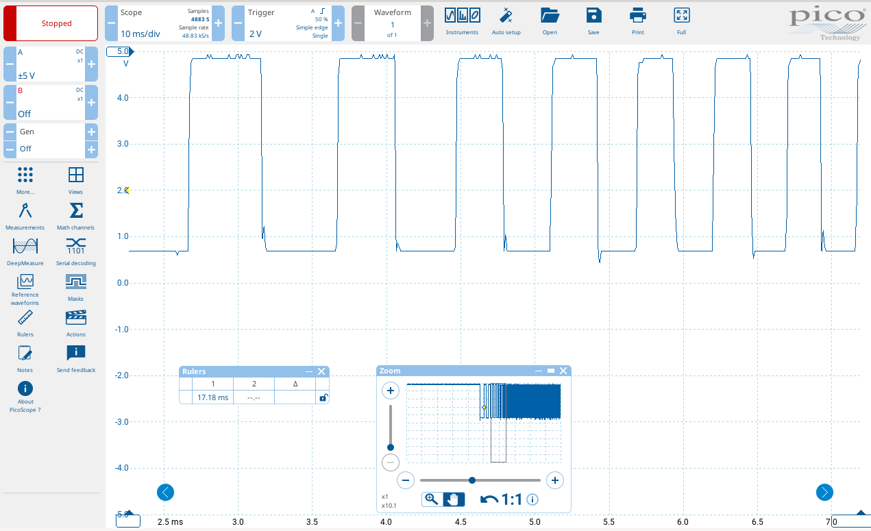

06 Nov 2024 03:21 #313869 by mBender
Heureka!! The new level shifter came in today and it works! I used the 3.3V to 12V and supplied 5V to the high voltage line. Even that works. On the Oscilloscope the Input side looks like a perfect square wave, the output side has a raising edge which is not super vertical. It looks like to doesn't make an issue. Will test the 3.3V to 5V lever shifter and see if that makes a difference.
What is the expected behavior of the direction signal. I was expecting that it's either permanently high or permanently low depending on the direction. It looks like that it's either permanent low and high only when a step impulse is created. Meaning it is kind of a square signal too. Is that correct?
Another question: I am running the tang 9k with ethernet. What happens if the ethernet connections drops during a move. Will the motors just stop?

06 Nov 2024 14:58 #313912 by mBender
Awesome, I tested it this morning again. This is the signal of the output of the level shifter. Looks better as I had it in memory. I also confirmed, the Direction Signal is not a square signal. It's either on or off all the time depending on which direction the machine is traveling. It goes off, once the machine is not moving. I noticed there is sometimes a bit of delay until the direction signal goes off. I was able to see that when I looked at the LEDs of the level shifter.
I also noticed that the machine sounds smoother as when I run it with software stepping.
