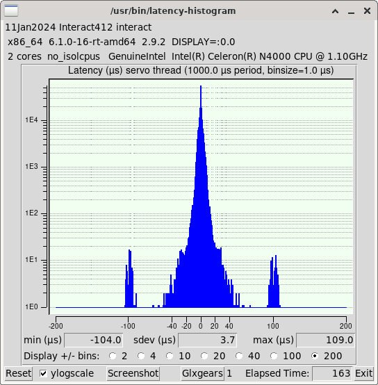

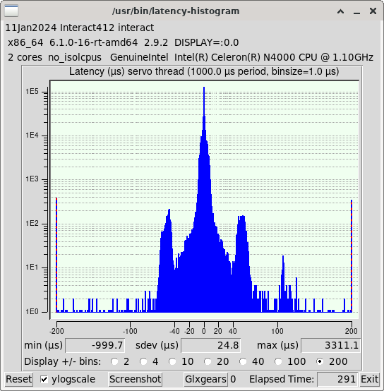

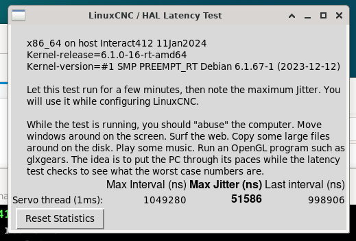

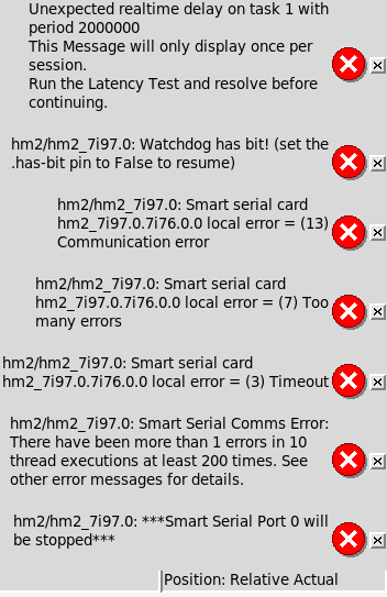

My old Optiplex bit the dust, so I picked up a very inexpensive micro PC off Amazon, a BMAX running an N4000 processor with 8gb of ram. I had no idea if this was suitable or not, and now I'm suspecting not. I got LinuxCNC 2.9.2 installed, but I'm getting errors. See the attached images. Also attached are my INI and HAL files. Based on the histogram latency, I suspect there's still power management turned on somewhere maybe? I'm running a Mesa 7i97T and 7i76.

Have you disabled all power management options in the BIOS?
(C states > C1 EIST, turbo modes etc)

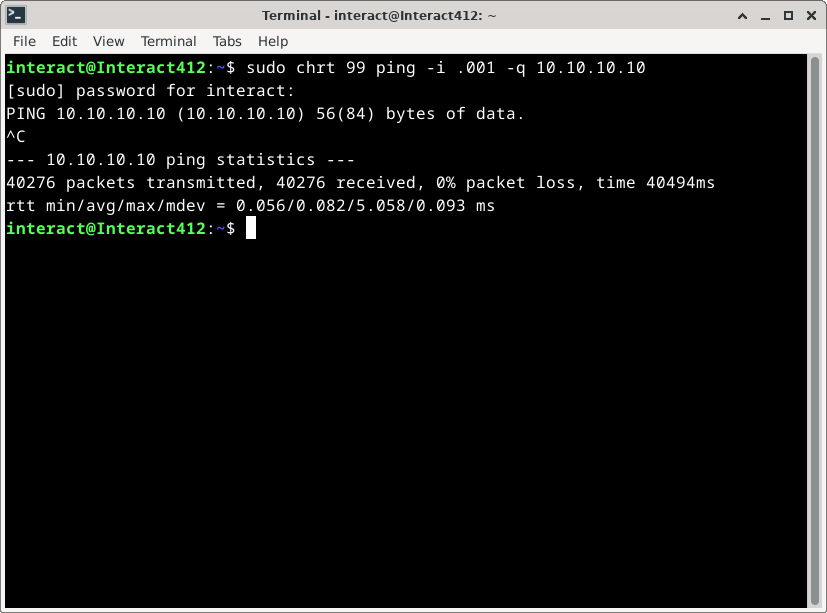

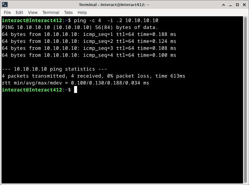

What are you ping times like?
First:
ping -c 4 -i .2 10.10.10.10
Then:
sudo chrt 99 ping -i .001 -q 10.10.10.10
Stop the last command after a minute or so with control C to see the stats

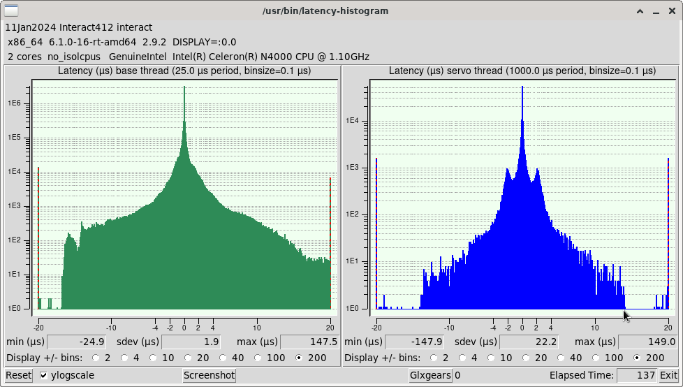

Also for the latency-histogram you should not use a base thread as it will
skew the results since that CPU/OS cannot handle a 25 KHz base thread.
latency-histogram --nobase --sbinsize 1000
First:
Then:

Ping numbers seem okay, I've turned off as much power management as I can find,although I know there are C States and I cannot find them again... Realized the latency histogram included opening linuxcnc which probably broke it - uploaded another image

Do you still get real time errors?
The 1.1 GHz is not terribly promising, you may need to run a lower servo thread rate like 2 ms on that hardware

I think the hardware is too under powered, I'm still getting errors at 2ms.

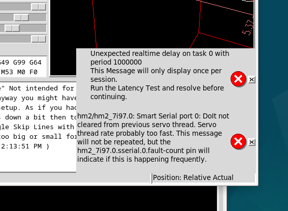

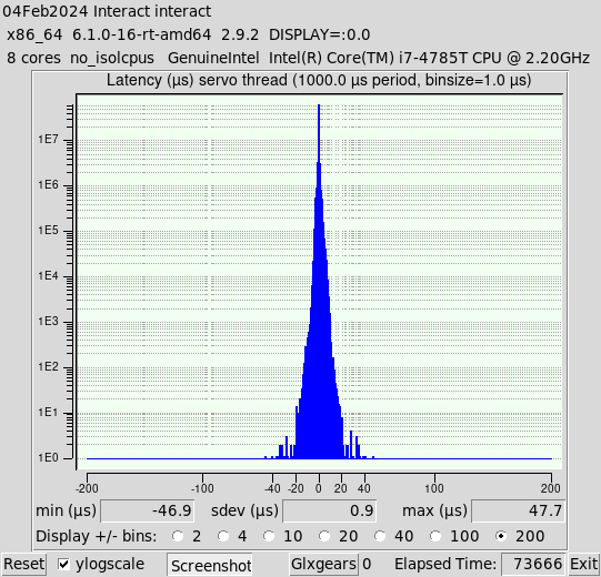

New Computer, similar problems... See the attached error warnings. This is on a new(er) Optiplex 9020 with 16gb of ram. As you can see from the latency histogram, I don't seem to have a real latency problem, but I'm still triggering these latency errors and communication errors...

Disable "hyperthreading" in BIOS

Make sure you disable IRQ coalescing if you have an intel MAC on you motherboard
Also disable all power management, EIST, Turbo modes and Cstates >C1 in the BIOS
What ping time do you have?

Pings are between .2 and .33 ms, 0% loss. All hyperthreading, C States, Turbomodes, etc is disabled. Only thing still on is Multi Core Support i did not see IRQ coalescing
edit: Turning off multicore support did not help

sudo ethtool -C eno1 rx-usecs 0
Try this.
