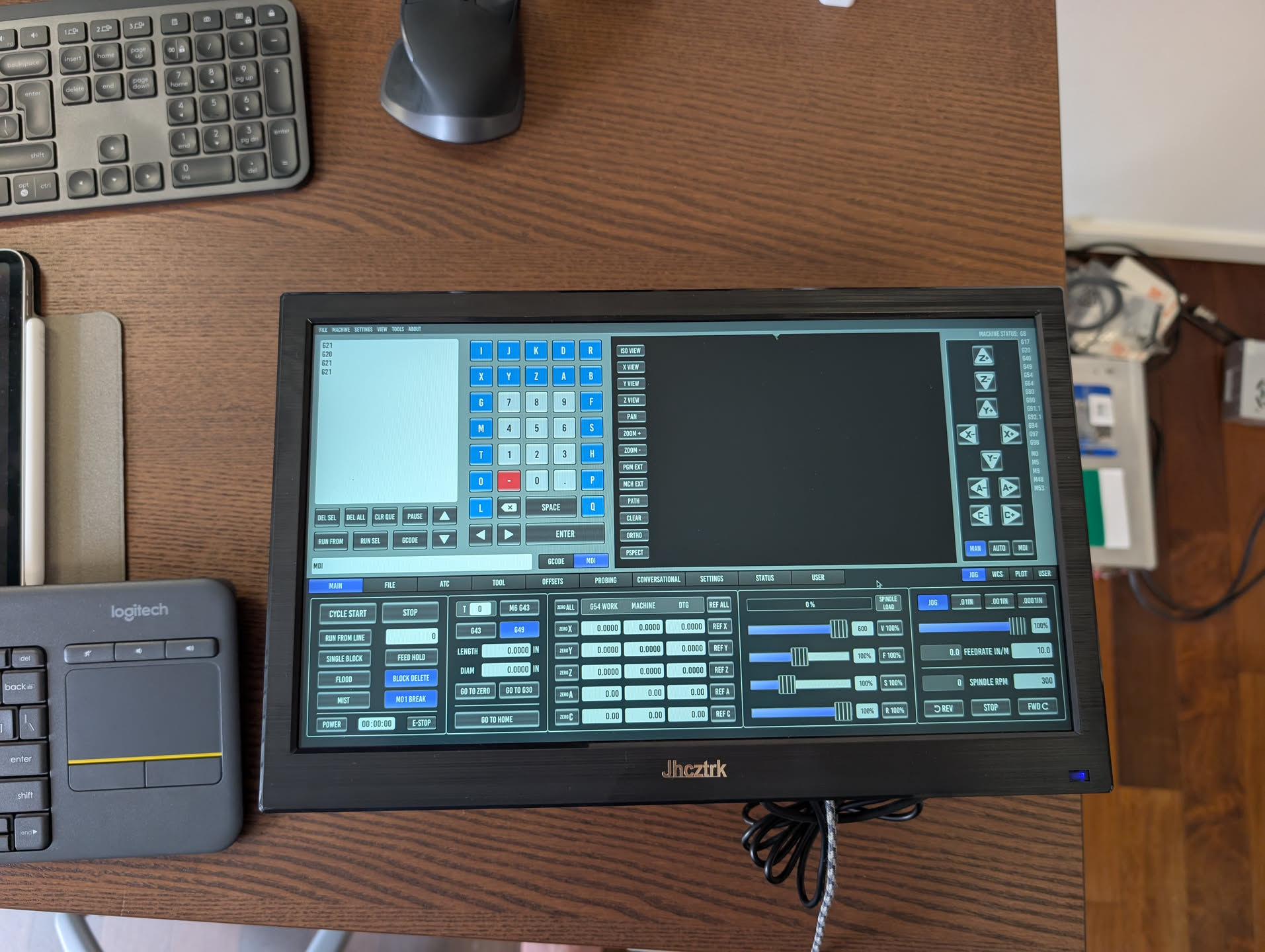

Hello, I have gotten Linuxcnc running in my RPi 5 with MESA and am now moving on to cutting chips
the original build uses a 10" Raspberry pi touchscreen (this:
Cool hood 10.1 RPi screen),
but I can't get the touchscreen part working. In the meantime I realize that 10" is small and I'd love to use the Probe Basic interface which required Full HD (1920*1080).
QUestion is: what touchscreen in 12-15" size have been proven working with a RPi 5?
I am interested in the Waveshare 13.3inch DSI LCD ( Waveshare ) as it seems to fit from compact dimensions and have drivers for bookworm. I see these are dependent on kernel though so I am now fearful it may not work with our RT kernels?
Any experience or other recommendation?
Thanks!

1 year 7 months ago - 1 year 7 months ago #325380
by StoneB
Replied by StoneB on topic Raspi 5 touchscreen experience - recommendation
Thank you for the guidance!

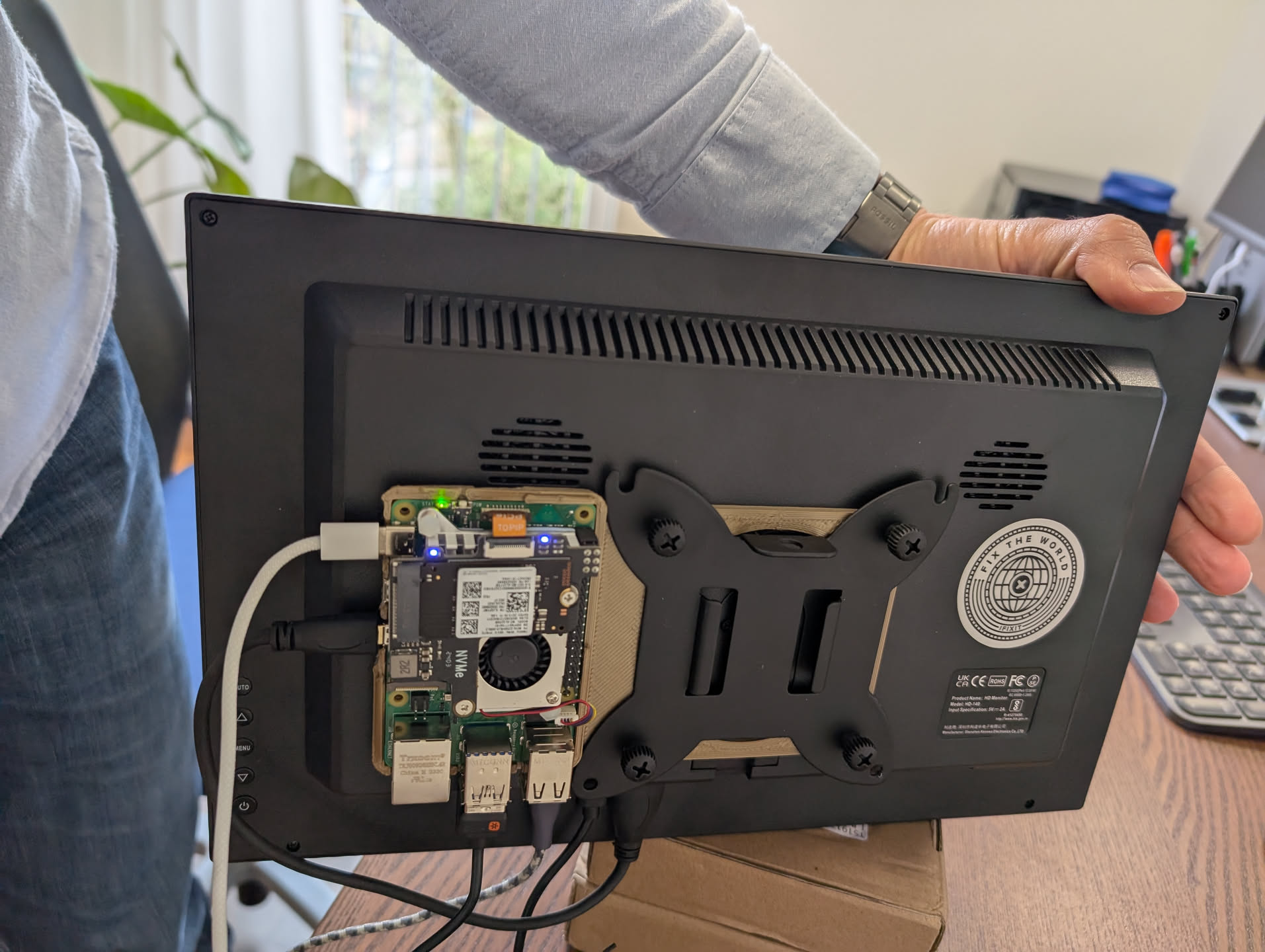

I got a super cheap 65eur 14" touchscreen off Amazon where the seller stated it is USB HID and it works just perfectly fine first try. Much easier indeed to use standard USB than trying to make drivers work for a dedicated solution.
Couldn't be happier how it turned out - using the VESA mounts to attach the raspi on the back, and have a desk stand I will mount to the back of the mill stand to hold the screen in place.
