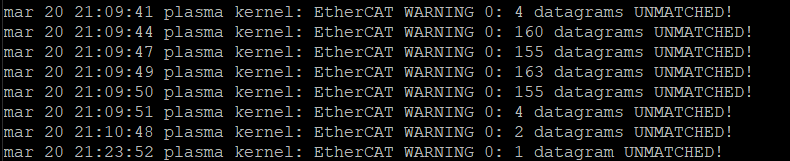

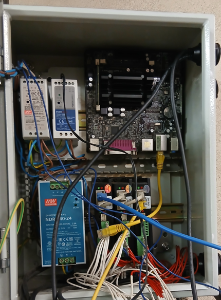

For some time I have been setting up a plasma system using a N100 mini-PC and ethercat drives 3xECT60 and one of my own Metalmusing EaserCAT-7000 board for IO and torch height. It is working fine, but there is the occasional, sometimes more than occasional message in dmesg/journal, datagrams UNMATCHED
In this case it is not a catastrophe, the ethercat cards easily recovers.
It means that the EtherCAT server sends out a packet and expects a packet back. For some reason it doesn't come back in time (I think).
So the focus is on this mini-PC, a T8 Firebat pro plus. It has two network ports, both Realtek. It is small, draw around 10 W, three HDMI and three USB 3 ports. Had the network worker better it would have been good, but no.
The network ports areI have of course tested with the realtek dkms driver, and added boot options. It gets better with the dkms driver but there is still the occasional datagram UNMATCHED. I don't want them.
I have seen in the past that all Intel network adapter perform better than this. So I will add an Intel network adapter to this mini-PC.
What I have in mind is to replace the WiFi card with some kind of ethernet card. The WiFi is an M.2 card, size 2230.
That's the options I have. No PCIE, no mini-PCIE. Just a M.2 2230 E-key WiFi card position.

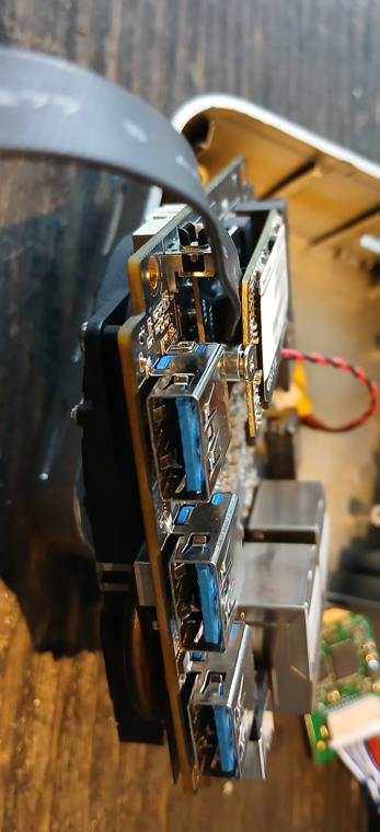

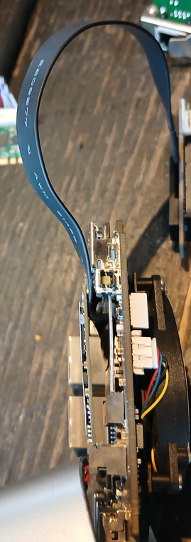

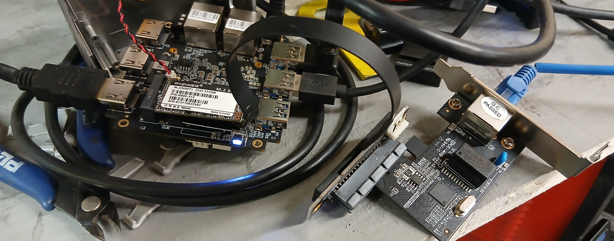

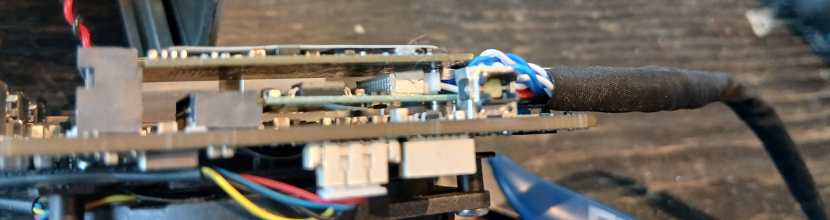

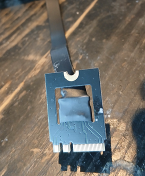

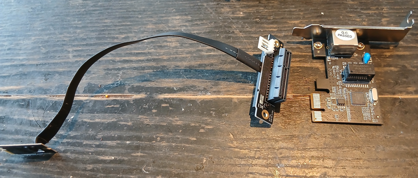

My first experiment was to add an M.2 to PCIE adapter, and put in an Intel I210 card I have.Here is what that looks like
There is the small M.2 card that goes in the slot and then there is the rather stiff cable that connects to the PCIE slot. And I plugged in the I210 there.
The biggest problem with this setup is that relatively stiff cable. It runs right over the screw that secures the M.2 board in place. I had to bend the cable, it is quite stiff. The cable became sandwiched between the adapter board and the M.2 system disk that sits on top. I got it there in the end but not ideal.

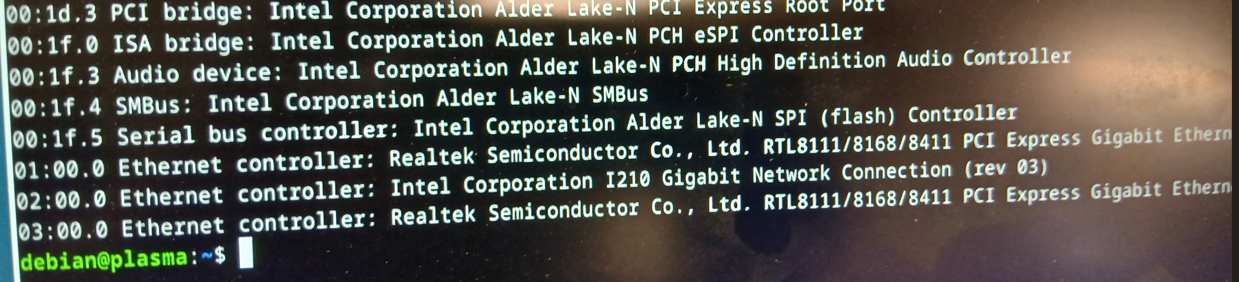

As for the function - brilliant! After startup, the I210 showed up as a PCIE network adapter, it showed up in the interfaces list. I did nothing, just started the mini-PC.

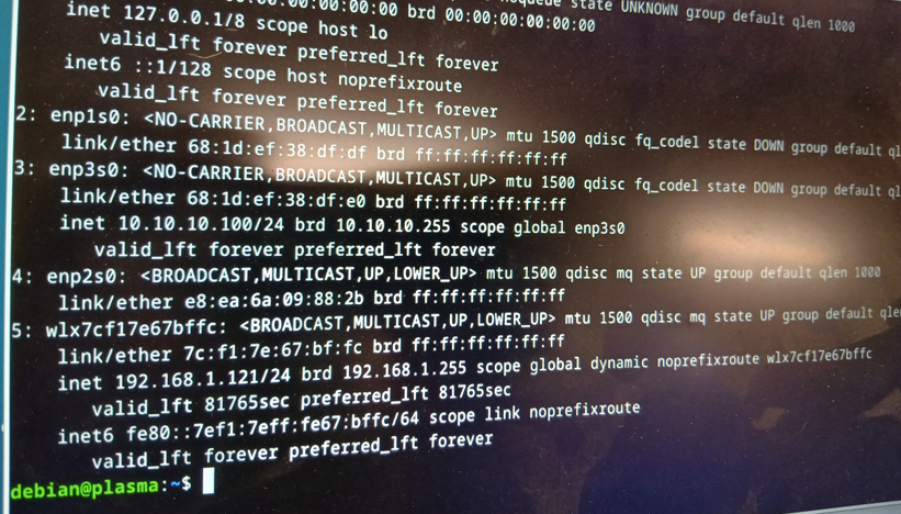

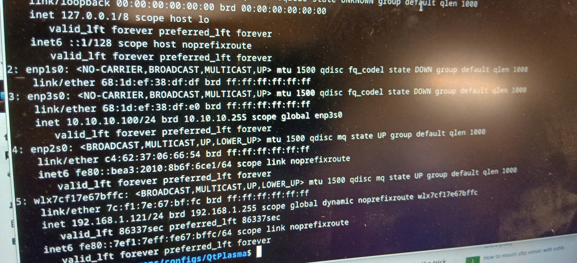

I put in the MAC-address for the new adapter into /etc/ethercat.conf, and restarted ethercat service.
There were no initial datagram UNMATCHED messages, so I use the plasma table for some minutes.
Even after a day there were no datagram UNMATCHED messages, so I call that a win.
I even went back from isolcpus=1,2,3 to no isolpcus, it works just fine without that.
The verdict is: it works.

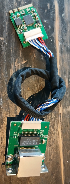

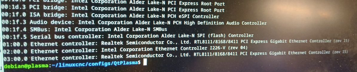

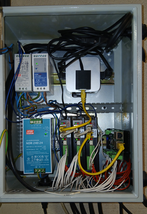

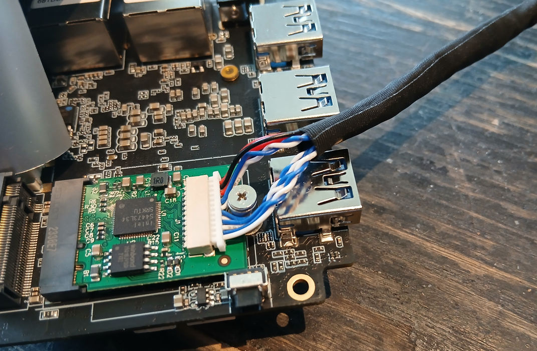

Next I tested a M.2 ethernet adapter, Intel I226 on a M.2 card and a cable to lead out to the RJ45 connector.
It's the same M.2 A+E key 2230 size card.
It turns out the cable runs over the screw also in this case. The cables are now much thinner and much easier to bend so it isn't particularly easy to make room for the securing screw but can be done. I think I broke the connector on the board but it continues to work.
The function was just as good with this M.2 network adapter. The adapter showed up in the pci listing automatically, showed up in the interfaces list also automatically and when I switched ethercat config to this new network adapter, ethercat worked just as well.
I decided to use this one, mostly because it was easier to make a nice installation. Here it is where the RJ45 connector is in a plastic housing, glued to the top of the T8.
The verdict: It works. Tricky with the cables on the M.2 board. Easier to make a nice installation of the RJ45 connector.
