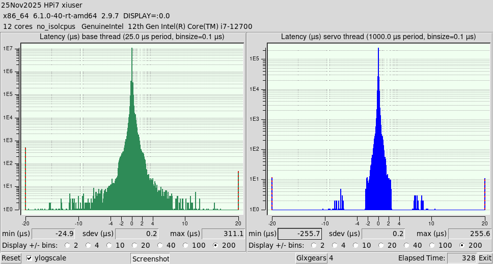

This is the latency histogram before tuning:

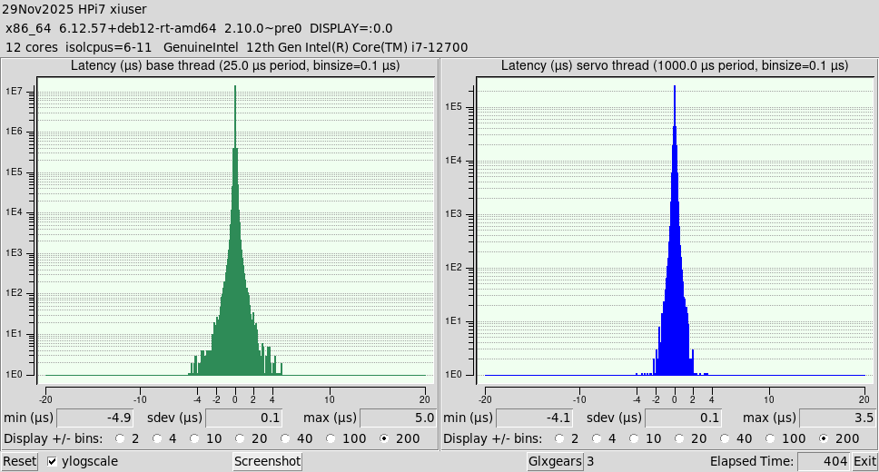

And this is the histogram after the changes...
First change: A new kernel that includes the new Intel Xe video driver, which will replace the venerable i915. Xe is in kernels >= 6.12.
kernel-vers -v: #1 SMP PREEMPT_RT Debian 6.12.57-1~bpo12+1 (2025-11-17)
Second change: the GRUB_CMDLINE_LINUX_DEFAULT boot line in Grub. Now cmdline is:
cmdline: BOOT_IMAGE=/boot/vmlinuz-6.12.57+deb12-rt-amd64 root=UUID=6dec6435-2cb8-427a-9697-c8d82ce45bdb ro net.ifnames=0 skew_tick=1 nosmt=force kthread_cpus=0-5 irqaffinity=0-5 rcu_nocb_poll rcu_nocbs=6-11 nohz=on nohz_full=6-11 isolcpus=6-11 intel_pstate=disable amd_pstate=disable idle=poll cpufreq.off=1 cpuidle.off=1 intel_idle.max_cstate=0 amd_idle.max_cstate=0 nowatchdog nosoftlockup i915.force_probe=!4680 xe.force_probe=4680
Note: force_probe => i915 OFF and Xe ON. My video device ID is 4680. Yours may be different. lspci gives the ID for each machine.
Third change: Modifying kernel parameters at runtime:
sudo sysctl kernel.timer_migration=0
sudo sysctl kernel.sched_rt_runtime_us=-1
