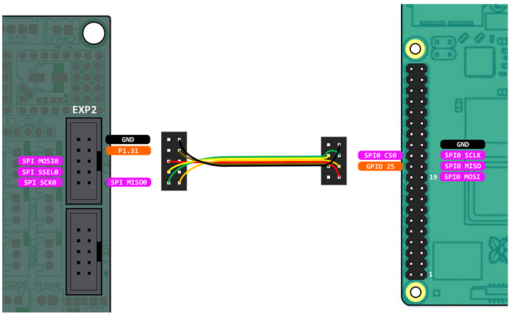

I have a skr1.4 turbo board. Would like to use ethernet to connect it to a pc instead of using a Raspberry Pi. Did see the demo of it working. Searched through the threads here and couldn't find how to wire and configure it.

10 months 4 weeks ago #339751
Replied by tommylight on topic Remora sk1.4 with ethernet?
Docs on github linked on that topic, at the very start of it
remora-docs.readthedocs.io/en/latest/har...ring-to-raspberry-pi

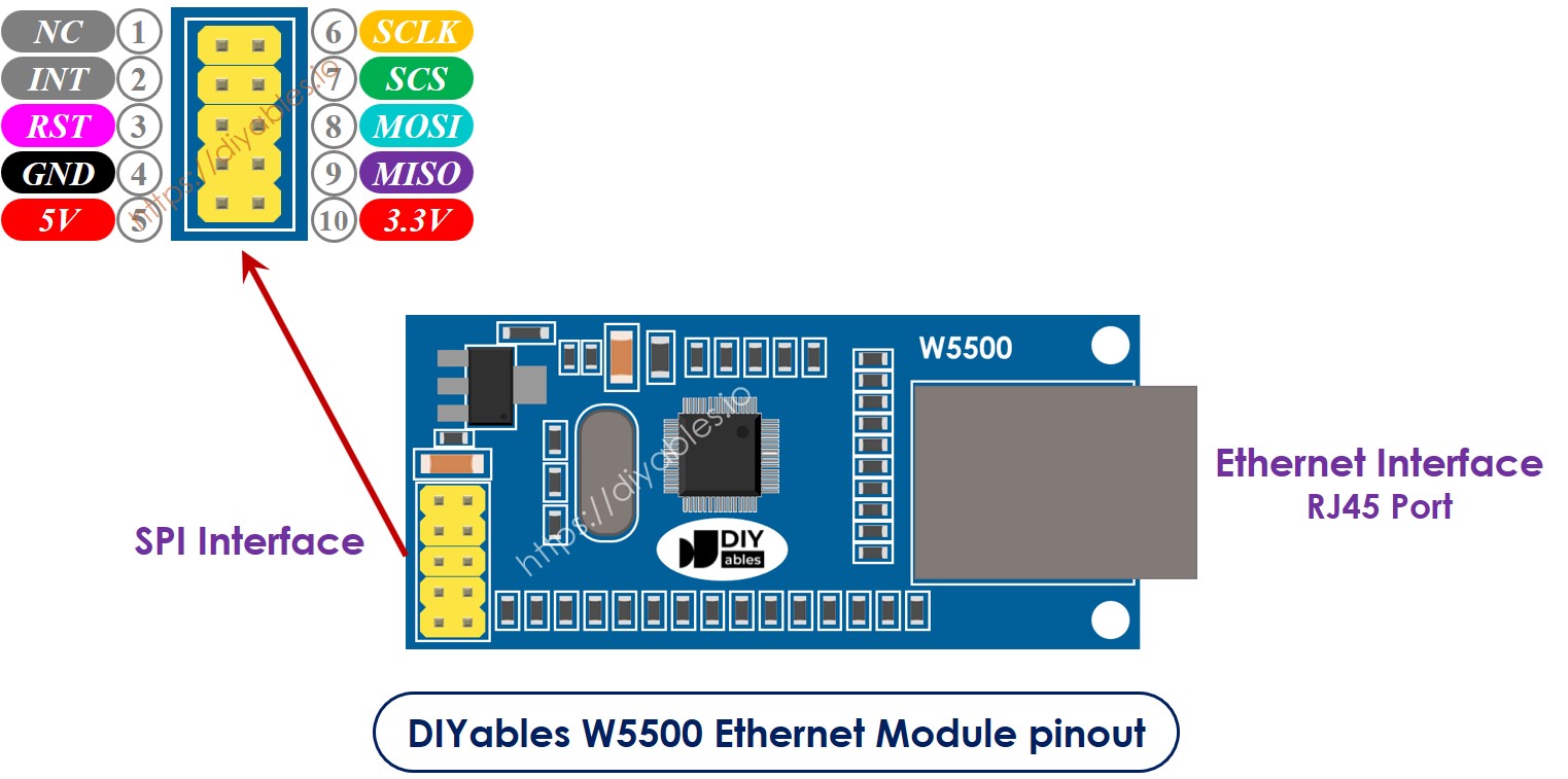

I searched through the documentation before starting this thread. That only shows how to wire it to a raspberry pi.
As I said at the beginning I do not want to use a raspberry pi. I want to use a w5500 ethernet board. Then connect with a pc. Like shown in the demo video.

10 months 4 weeks ago #339785
The same pins used on RPI are on the W5500, those are the SPI pins so the wiring is the same.
Just check the pin naming.

10 months 3 weeks ago #339931
by Punisher
Replied by Punisher on topic Remora sk1.4 with ethernet?
Thanks that clears up most of it. On the 1.4 board there's pin p1.31. What would that connect to on the w5500 board? In the video there's a power supply going to the w5500 board. Does it need 5v, 3.3v, or both? The documentation shows that it's possible to power a raspberry pi with the 1.4 board. Is it possible to do the same with the w5500 board? Looks like there's 5v there.

10 months 3 weeks ago #339952
by scotta
Replied by scotta on topic Remora sk1.4 with ethernet?
The SKR1.4 is not actively supported and the ethernet demo was an early concept testing. Please check this link for ethernet supported boards.
remora-docs.readthedocs.io/en/latest/har...hernet/ethernet.html
