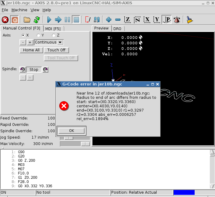

This thread was inspired by the experiences of ctrl-frq in this thread
www.linuxcnc.org/index.php/english/forum...ounce?start=10#54172
trying to get the arcs generated by his CAM program accepted by Linuxcnc.
Anyone who has done any amount of work involving arcs will be familiar with the error message as per below
In this particular case the variation is pretty small, but enough to prevent usage of the code.
This started me looking at the code the interpreter uses to test if the divergence is within tolerances.

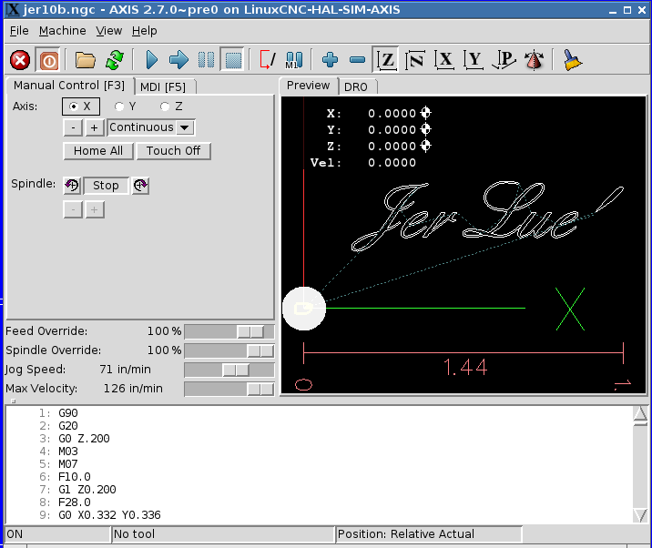

Below same code run through a build with imperial tolerance set to 0.002"
Runs quite happily and given the arcs in question are used in script on a sign, is there actually any point in having the tolerances so tight that
3rd party code is not accepted?
