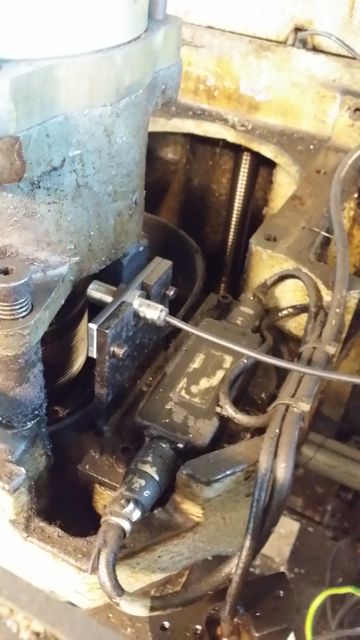

i am almost finished with my bridgeport retrofit now at training stage i found out that G33.1 (because i normally don't use it ) doesn't behave as it should.
i have also prepared an python drill script generator which i donate when we solve that
So i go to lets say g0 x0 y0 z0.5
S200 M3
G33.1 Z-3 K1.5
i would expect that it does go down to Z-3 in the needed speed to achieve 1.5 per revolution
so far so good (i looks that i have a glitch from motor to spindle it is a 1:2 ratio but ,.. )
so i use a bigger number in K to achieve the ratio )
but when the system reaches Z-3 it reverses the spindle also ok
but then it proceeds i stopped it then at Z-30
so has anyone seen that behavior and how can i check what i probably have done wrong ?
or if someone has an Working G84 script which i can remap would also help a lot
i use now the latest live cd and do updates
so any hint welcome
thx

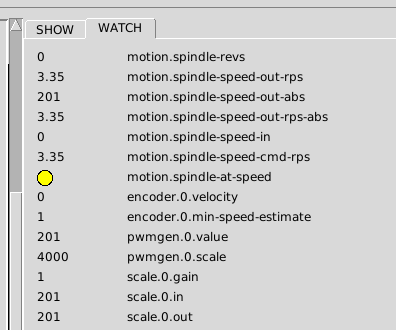

i now build an 2nd Probe to my config and can get some better insights
My question which values does the 33 command take in consideration ?
This is an example where i have 201 as RPM and 3,35 as Rev/Sek
And when i turn the direction i is negative
Is that correct ?
Is there an example to work from ?
thx
thomas

G33 uses the value of motion.spindle-revs (revolutions, not rpm)
You need to set up the encoder scale so that one rotation clockwise of the spindle gives an increase of exactly 1.0 in motion.spindle-revs and one rotation anticlockwise makes it _reduce_ by exactly 1.0.

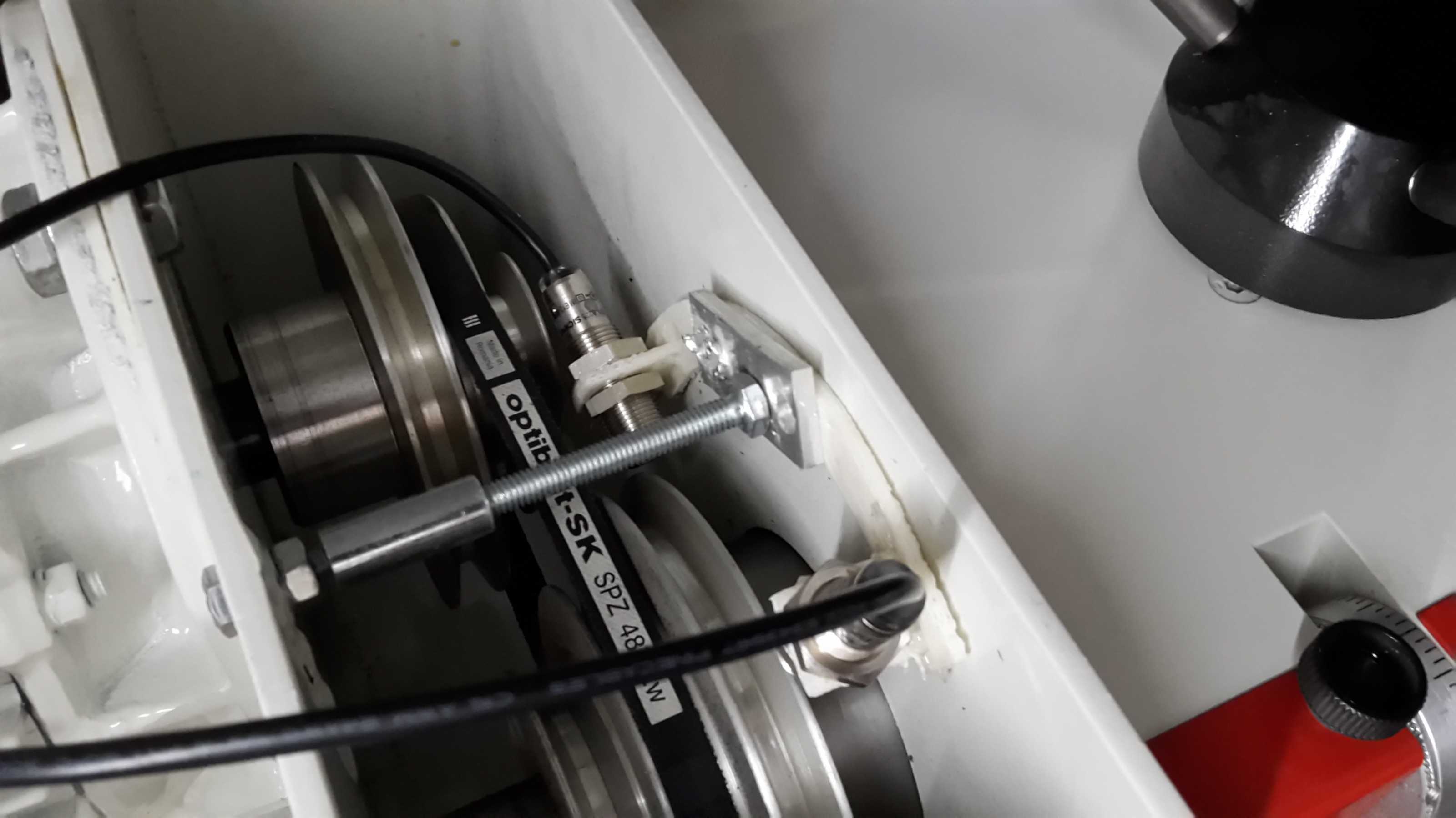

Hi PCW ,
thank you for you answer i hoped that i can do it without big changes on the bridgeport
my idea was (because on the original
here my adaption ) to use only one "ping"
i now learned that this is not enough
So Plan "B" i build an test on my mill
where 2 "Probes" are 90° separated and only 1 steel plate is doing the signal so i hoped to get an A/ B Signal (which i do ) which gives me perfect speed .
but revs are not counted !!! i denn put the index signal to A and later to b signal then the revs never get bigger than 1 or -1
So my conclusion would be to put more metal plates (just for test ) on the spindle to get lets say 4 a/b per revolution and i add an longer metal plate and mount a 3rd "probe" to get the index signal
this would lead to an poor mans encoder ,..
so if someone had done ist similar i would go that route because i have everything at hand (but time)
or if you say encoder i have some AMT 101 Encoders on stock ( www.digikey.at/product-detail/en/AMT102-V/102-1307-ND/827015 ) but the mount on the Bridgeport will be very complicated ( on my lathe i am on the way to do that but that is next task )
So if someone can lead me in the right direction this would help me big times
last resort would be to go the Encoder route
thanx

You probably want more than 4 pulses. Home-made encoders normally have 50+ slots and commercial ones have 1000+
Do you know what the response time of you sensors is? At high speeds they may start missing edges.
