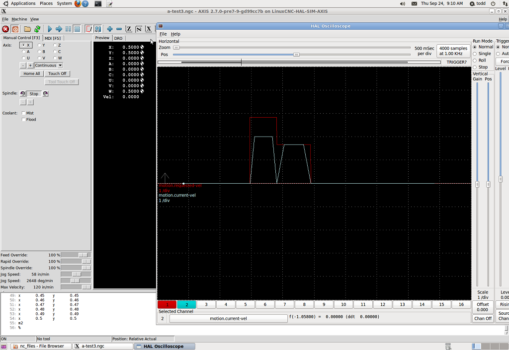

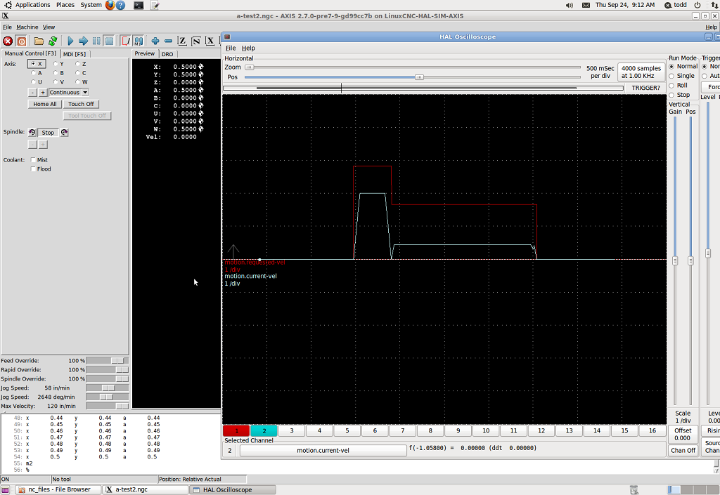

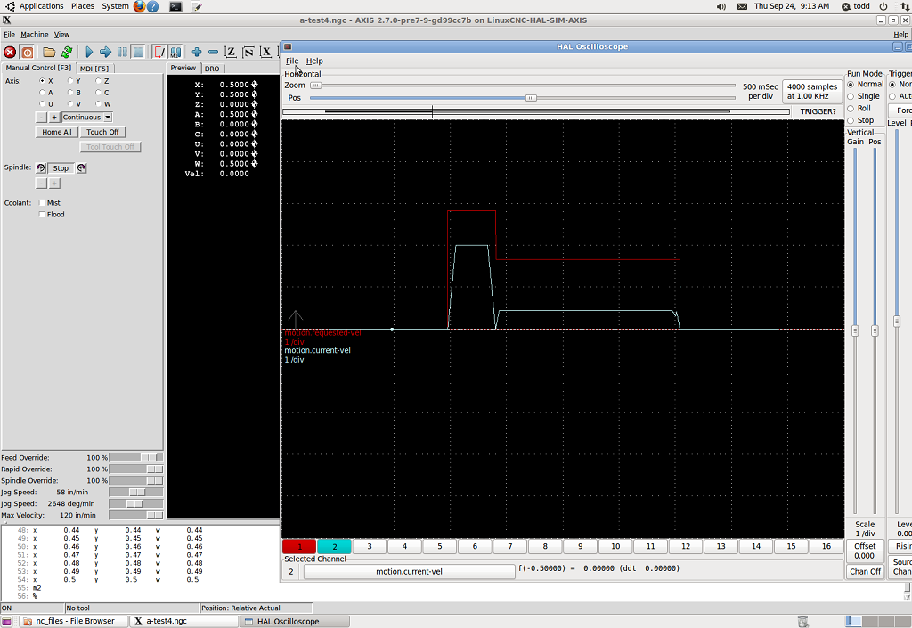

24 Sep 2015 14:51 #62943 by Todd Zuercher
Replied by Todd Zuercher on topic Coordinated Motion involving rotary axis
I ran your test on the 9-axis sim as well because you didn't mention the actual velocities achieved (and I wanted to know). And what I saw, I believe, is what I've suspected, that when movements are made in any other axis than XYZ the planner reverts to the old trajectory planner and its must be able to stop by the end of the next line look ahead, therefore full speed is never achieved with short line segments. (unless the acceleration is high enough to go from 0 to full speed within the length of the next line segment) When the test file is restarted and the tool retraces its previous movement in a single command, full speed is achieved.
I do not know if any work is being done to extend the new trajectory planner beyond XYZ.
24 Sep 2015 15:30 #62944 by Todd Zuercher
Further testing I think shows it. I ran that test file as is, with A replaced with W and with only XYZ and this was the result. The velocities for A and W were identical, and XYZ was as you'd expect.
A-Test
W-Test
XYZ-test
