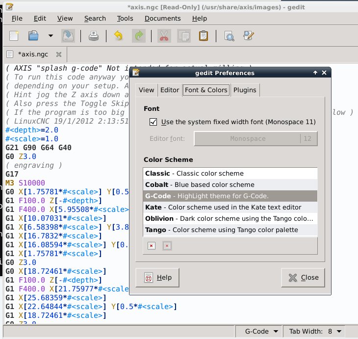

For those of you that prefer using gedit, I wrote a new HL file for you.
Just copy ngc.lang.txt file to either (REMOVE THE .txt EXTENSION)
/usr/share/gtksourceview-3.0/language-specs/
or
~/.local/share/gtksourceview-3.0/language-specs/ (you can also use 2.0 instead)
and GCode.xml (colors) in
/usr/share/gtksourceview-3.0/styles/
or
~/.local/share/gtksourceview-3.0/styles/
then restart gedit, open a ngc file and select GCode color scheme
here what it looks like
If you do not like the colors I selected, try to find a scheme you like or edit GCode.xml by inspecting ngc.lang to see how colors are mapped
Best regards
Fernand

I'm using Gedit on LinuxMint 17.3 but don't see the directories you mention.
JT

I don't have Mint, but i believe it is shipped with GTK2 so you need to look for /usr/share/gtksourceview-2.0/ directory

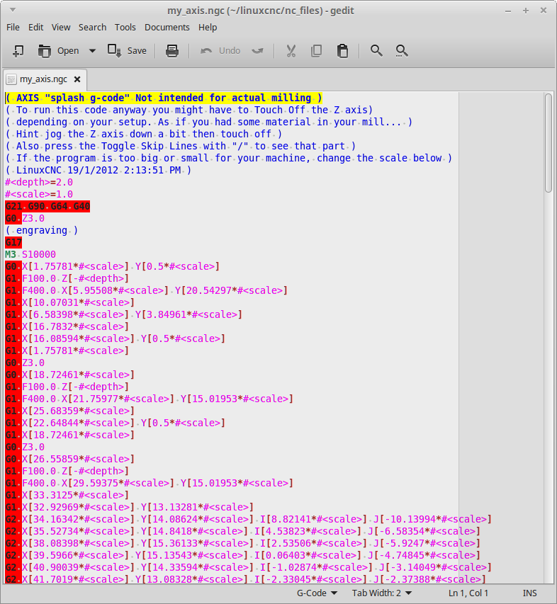

23 Apr 2016 11:32 - 23 Apr 2016 11:51 #73744
by BigJohnT
Replied by BigJohnT on topic New syntax highlighting for gedit
Last edit: 23 Apr 2016 11:51 by BigJohnT.
- Amedee
- Posts: 56
- Thank you received: 13
23 Apr 2016 13:01 - 23 Apr 2016 13:02 #73749
by Amedee
Replied by Amedee on topic New syntax highlighting for gedit
Last edit: 23 Apr 2016 13:02 by Amedee.
The following user(s) said Thank You: BigJohnT
- BigJohnT
- Posts: 3990
- Thank you received: 994
23 Apr 2016 14:26 #73757
by BigJohnT
Now that looks much better and I even like it!
JT

Thank you so much to FernV for this. It is just what I was looking for and the old links from the LinuxCNC manual were dead.
Two comments though, from this extremely inexpert user.
The first is that in my version of UbuntuStudio 24.04 with Kde both the language-specs and the styles directories are in /usr/share/libgedit-gtksourceview-300/
The second is that after I put Gcode.xml into the styles directory, highlighting did not work until I renamed Gcode.xml to ngc.xml
Now it works great!
