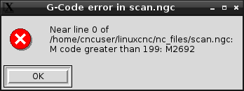

Does nobody know what the cause of this error is?
It's peeing me off now and only started since I played with NativeCam .
It don't matter what I do I can't clear it, I even went back to the old Wheezy 7 I had on dvd and installed from that.

What does scan.ngc do? There must be a variable attached to an M code there that changes its value somewhere in the process. Are you using remap? Chect if a O sub is calling scan.ngc and why and how it is related to M codes.
Normaly M codes can not change by just running an ngc file.
Provide us with more info and attach the hal ini and ngc files you are using when that happens.

Hi Tom, scan is just an engraving pattern, it doesn't matter which ngc file i try to use its just not having it.
I have to load the file before homing, once a home button is pushed it won't let me load a different file.
I then need to restart axis and load a file before homing. There is nothing in the G-code to create this.
Research seems to point at the [RS274NGC] but there is little to research on Google.
I have installed Jessie 8 this morning and downloaded from the Buildbot a new lcnc uspace setup my mill with stepcof wizard and generated a fresh engrave ngc with F-engrave and still get the same error.
I am not doing anything different to what I have always done and it happens now on all my computers even the simulated laptop which has a git clone lcnc, stretch 9 and 4.9.0-2 rt.
It only started recently and won't relent.

I am seeing a similar error with 2.8.0-pre1-3126-gcb74ca8
After running a few NGCGUI routines then i get a error about an m31 code - sometimes different numbers show up.
After than the back plot no longer shows
If i exit Axis/LinuxCNC and re-run the last command - it works with no errors.
Smells like a memory leak or something similar...

Been running your scan.ngc file several times on 2 of my configs, no error ever. Load, run, reload, run, open again, run, all is good.
I am at a loss, as your ini file contains no remap, so i can not fathom why would it error on M2692 and where is it getting that on line 0 !!!
Did you by any chance edit the files on a windows computer? That tends to cause some unlikely errors.

I know there is nothing wrong with either the ini fie or the ngc file they are the same as I always use.
Microsoft, refuse to use any of their software, won't have it in the house so no to that question.
This error has only come about since I was playing with that NativeCam I am sure it can't be related but I also don't believe it's coincidence.
It can't be that because I have completely wiped and zeroed the ssd and reinstalled yet again to no avail.
I did notice some of the git files have recently been updated and wonder if there is a newly built bug to report.
Has anyone else updated or installed in the last few days?

To get back to the subject, I get a different M number with every file but it's always line 0 so something is looking in the wrong place to complete its task.
My answer to everything is to wipe off and start again which I have now done several times and still get the same result.
Leading me to be convinced it's not me but the system is failing.
Never allowed it in the home in all that time, Unix / Linux only.
I no longer work in that industry and wow what a release it is.
My grandson has a project of an old arcade machine to build and asked for help with it.
We are using a raspberry pi running Linux with a dos box for the games, he loves it, learning new skills and it brings back memories not all good ones and confusing where to put a capitol letter and which way the slash goes etc but we are there with it.
Bloody addictive these space invaders and Pacman.
