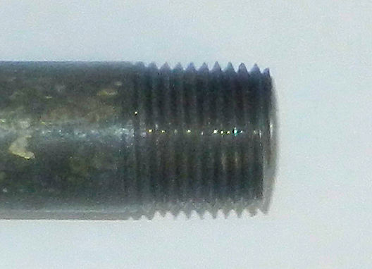

06 Jun 2017 15:09 #94175
by 10K
Replied by 10K on topic Hesitation between two consecutive G33 codes
Here's a picture of the threaded pipe:
There's a somewhat puny thread about three threads from the left end. That's the transition between G33 commands. It's not too bad on this sample, since I ran at about 100 RPM. If I run the lathe faster, it's much more pronounced.
I agree that the vanish taper is an artifact of the pipe die, and that this cut is an approximation. However, some transition is needed, or the thread would have to be cut too long. A steeper taper can help make up the pipe joint if the tolerance between the pipe and fitting is a little off.
