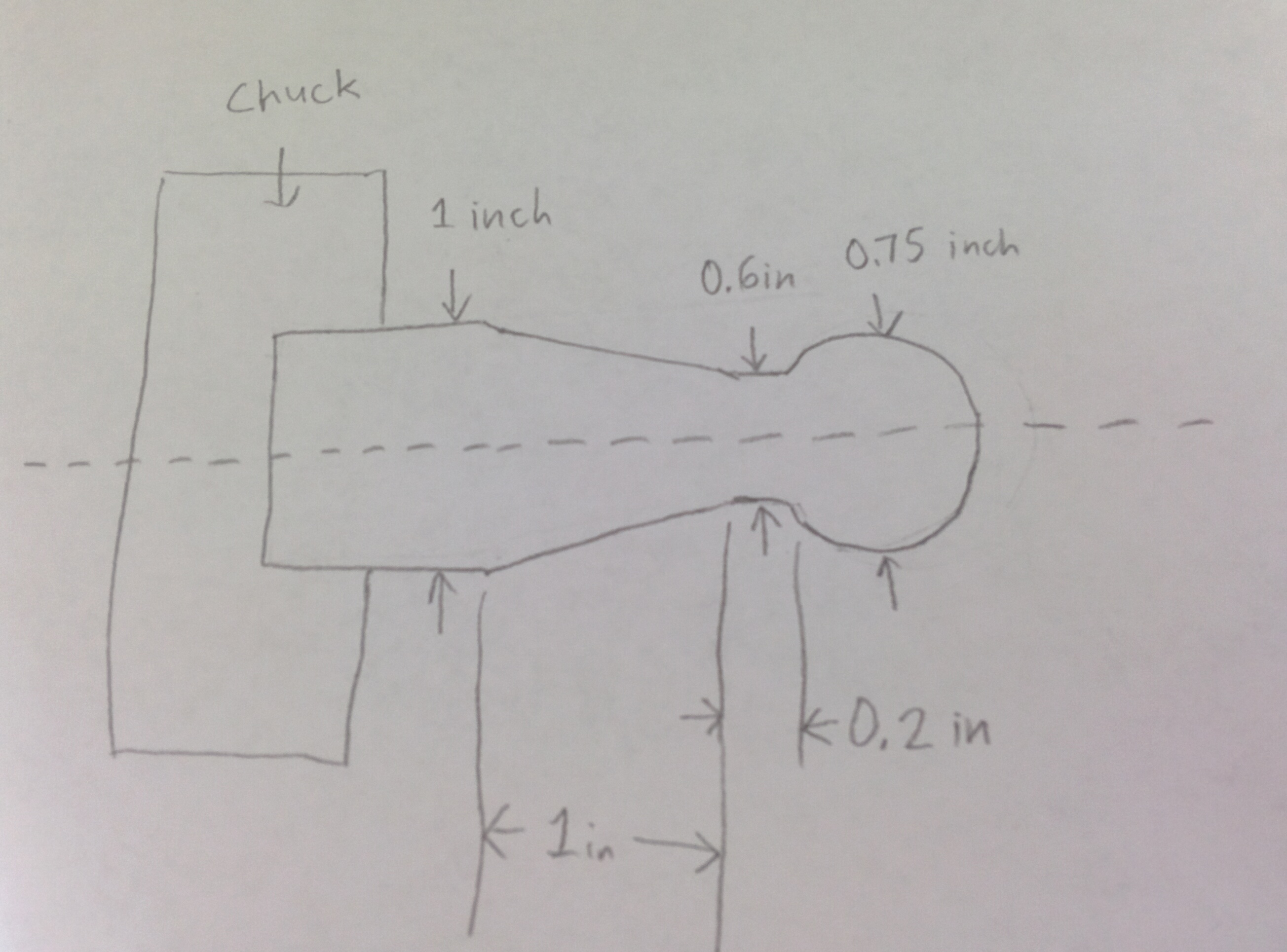

So I'm not sure if this is the right place to ask but I'm trying to learn some basic hand programming on my own specifically for cnc lathe. I've read as much as I can about some common g codes and what they mean as well as learning about the X and Z coordinates.
As an exercise I want to develop a program for the simple part in my sketch, but really just don't really know how to start. It has a taper and a ball shape at the end. Can someone show me an example program that show what's involved?
Another thing I don't know is what software to use to practice hand writing program in and use later to test run on a lathe. Can I type in something like Microsoft Notepad and save as text document?

You need to break the shape down in to arcs and lines and also work out where you want the roughing passes to go.
I would suggest first either making an accurate scale drawing on paper or using CAD of both the required shape and the starting stock.
You can then draw note the critical points where arcs and lines intersect, and draw in your roughing passes as horizontal lines.
Doing this will also allow you to determine what tool geometry you need to make the part. (40 degree back angle, according to the drawing I just made in CAD).
You will find it easier to work in radius mode when hand coding arcs on a lathe. And you need to be in the XZ plane. You might prefer to use absolute arc-centre mode too.Then spindle speed and feed rate. I like CSS and feed-per revAll your G-code programs will start like this.

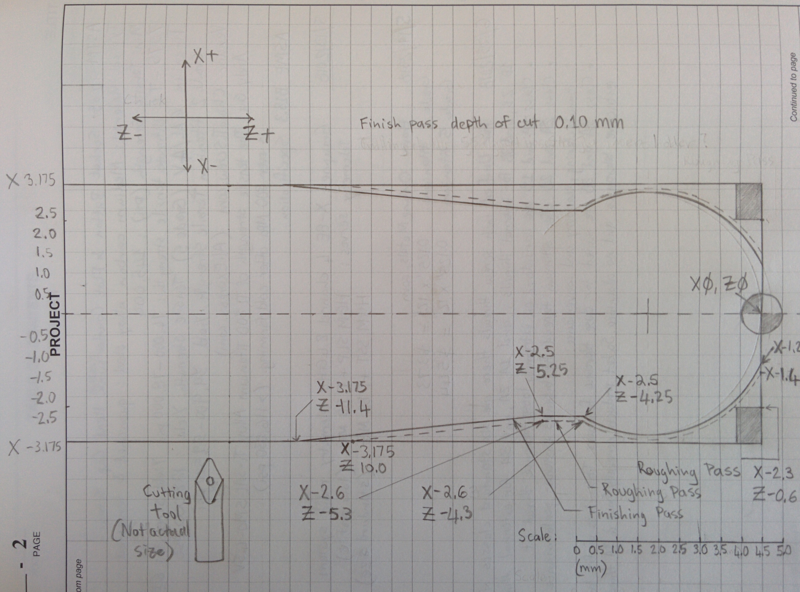

Thanks Andy for your suggestion. I sat down and made a scale drawing of the part I want to learn to program the cutting. The lathe I will be learning on is metric, not inches. So I changed dimensions on my scale drawing for the part to be in mm. The part is also smaller too because I will later practice making it from small 1/4" aluminum stock. The overall shape of the part is still the same as that in my original hand sketch.
I hand wrote the program below for the part. It has three main cuts. The first is the linear roughing pass that cuts out a small corner of the stock. The second is a roughing pass that follows the profile of the part but leaves about 0.10mm material thickness left for the finishing pass. And the last cut is the finishing cut (0.10mm depth of cut).
The second and last cut is a combination of linear and arc moves that I learned. All the X and Z coordinates I noted on the drawing are my best estimate based on the grid scale paper I made the drawing on (attached). I drew a cutting tool to show where it's located relative to the aluminum stock. The lathe has a cross slide and the tool is mounted on a quick change tool post. The tool will cut in front of stock (tool close to the operator).
As far as tooling goes, I like 55 deg carbide insert tool. For a profile shape like this, should I use it in a straight insert tool holder? In manual operations I only use LH or RH tool holders. But I'm afraid that a 55 deg insert in RH holder has about a 30 deg back angle, which probably isn't enough for proper geometry near the end of the arc cut. A straight insert holder will allow enough back angle for tight corners, but I don't have any experience yet with it.
The program codes I worked on:
G8 G90.1 G21 G18

I changed a few things, and got this.
I suggest you try the same thing, ie try running your code on the sim/axis/lathe simulator config to see your toolpaths.
I changed the negative X coordinates to be positive. (I don't think it matters with a lathe, but it seems an odd thing to do)
I changed the arcs to R format, because solving IK format from a hand drawing is difficult.
I changed the Z in G1 X-3.175 Z10 because that went straight through the ball....
Replied by andypugh on topic Beginner trying to learn basic programming
I wish you had said, I assumed inches from the drawing. I actually had to convert everything from metric to imperial, as I use metric pretty much exclusively.The lathe I will be learning on is metric, not inches.

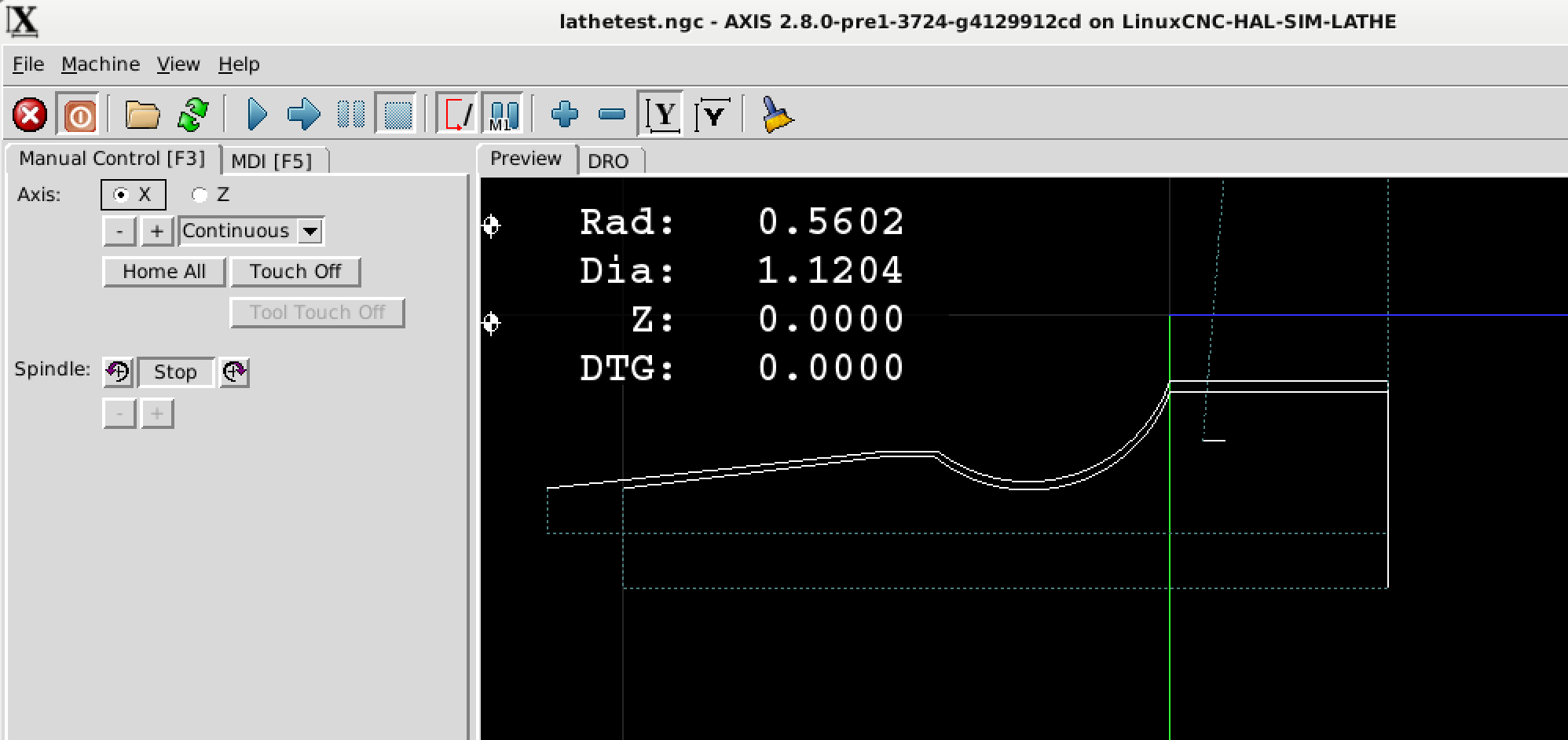

G8 G90.1 G21 G18
G95 F0.10 ; 0.10 mm per rev
G96 S91 ; 91 meter per minute converted from 300 SFPM for aluminum
M3
G0 Z1
G0 X-2.3
G1 Z-0.6
G0 X-4 Z1.1
G0 Z4
G0 X-1.4
G1 Z0
G3 X-2.6 Z-4.3 I0 K-2.75
G1 X-2.6 Z-5.3
G1 X-3.175 Z10
G0 X-5
G0 Z4
G1 X-1.2
G1 Z0
G3 X-2.5 Z-4.25 I0 K-2.75
G1 Z-5.25
G1 X-3.175 Z-11.4
G0 X-4
G0 Z4
M5
M2I changed a few things, and got this.

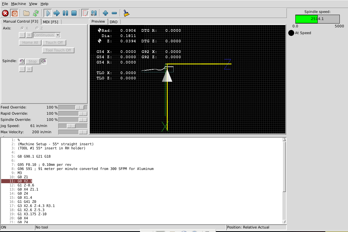

I made and saved the changes as suggested, and then open up the program in the sim/axis/lathe simulator config.
Before I can click run, I had to click home all axes (that when it moves and creates those two yellow lines parallel to the X and Z axes).
I then click run and for some reason it keeps stopping at line 11 ... I don't know what's causing that. This is first time I'm in the lathe simulator.

I think it is actually waiting for spindle-at-speed.
Though why the sim would fail to reach speed is a mystery to me.
Try adding D5000 to the G96 line

Ok it seems to be working now. Spindle max speed limit seems to be about 2500. If I set anything higher than that, the spindle would never be able to reach that speed. So I had to make it D2500 instead to the G96 line.
I do have a question about the G96 constant surface speed mode ... I believe that it automatically adjusts the spindle speed according to how close or far away the cutting tool position is relative to the centerline of the stock (Z axis), as the tool cuts along the profile of the part. However, I noticed that the spindle RPM pretty much stays constant @ 2500 throughout the entire program in the simulator config. Is that something that the simulator config doesn't take into account?

It looks like the sim config tops out at 2500, so that is pretty much what you will see with small diameter work and a high surface speed.
You can edit the config, though bear in mind that this limit might not exist in the HAL of a real machine.
Have a look in the HAL at the "limit_speed" pins and parameters.
(And note that, because of what it is, maxv = acceleration, and max = max velocity)
