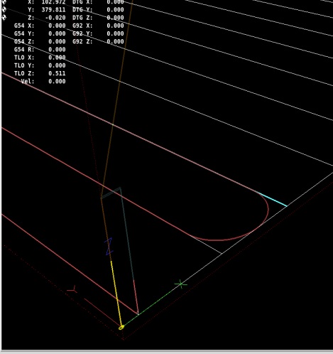

I have a spoil board re-surface program I created in Fusion360 with "straight line transition" enabled. When I run the program in a LinuxxCNC simulator I still get rounding, not straight line.
The program is fairly simple.
My machine is a DIY so I have relatively slow accel/decel values.
Is there somthing in G code I can edit to reduce the rounding?

G61 will get it.
Look at G64 to tune the system to what you need.

Now is there an in between command? I read and found a G62 corner override but LinuxCNC does not recognize it. Is there a adjustment to the rounding that is modal?

G61 is exact path
G64 is Path Control Mode with Optional Tolerance it is adjustable
I don't see a G62.

Perfect that did the trick. Thx!G61 is exact path
I don't see a G62.

G64 P.005 would be a decent in-between depending on cutter size and speed.
G64 is used to maintain constant speed so if you have low acceleration then it will round more corners. The P will allow it to behave similar but only round to .005" (or whatever your machine unit is).
G61 is exact path mode. Just beware of how much tolerance and smoothing you have in your fusion tool operation.
G64 with no P is default at start up. You can add G61 or G64 Pxxx to your ini file start up codes or you can modify every ngc code fusion spits out or you can change the post processor.
linuxcnc.org/docs/2.8/html/gcode/g-code.html#gcode:g64
