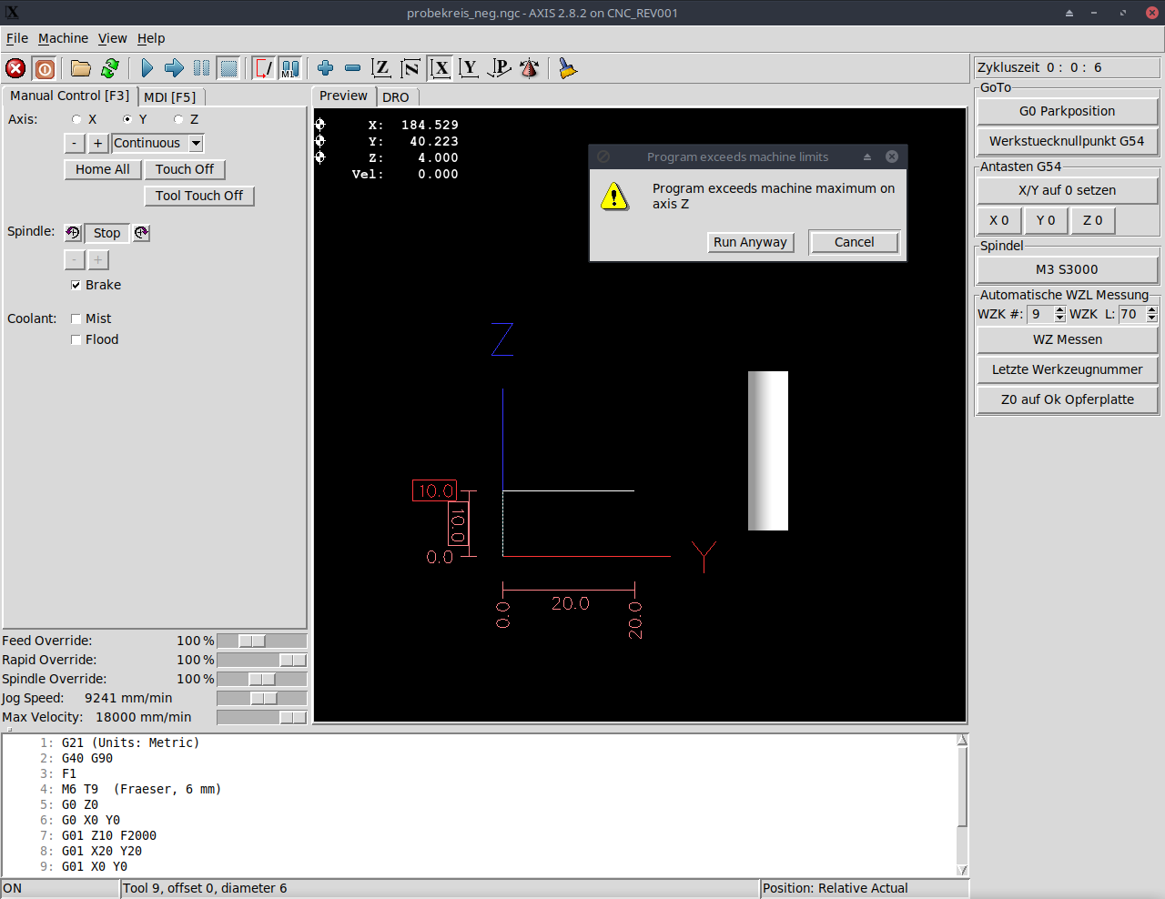

I have a small problem with dynamic tool length measurement with G43.1.
I call via remap a macro on this basis:
My adapted macro looks like this
My Z axis has the following specification
[AXIS_Z]
MAX_VELOCITY = 100.0
MAX_ACCELERATION = 700.0
MIN_LIMIT = -300.0
MAX_LIMIT = 0.01
My workflow is as follows.
1. tool measurement via the macro above
2. define Z0 (for the tests I set it far away from machine limits)
3. start program
If I now start a program I get the message, "Program Exceeds machine maximum on axis Z.". As far as I could understand, the error occurs when the machine is moved to different Z heights in the program run.

This however not only with the above mentioned error message:
G21 (Units: Metric)
G40 G90
F1
M6 T9 (Cutter, 6 mm)
G0 Z0
G0 X0 Y0
G01 Z10 F2000 (different height)
G01 X20 Y20
G01 X0 Y0
G0 Z0
M05 M30
If I then click on "Run anyway", the program runs through to the end of the cycle without any problems. However, since I have to click the message away every time and thus cannot use my external hardware start button, I would like to solve the problem. Does anyone have a troubleshooting approach?

I think that the problem here might be that probing always fails in the preview.
Judicious use of
Might fix the problem.
Judicious use of
O100 IF [#<_task> EQ 0]
simulate probe
O100 ELSE
actually probe
O100 ENDIFMight fix the problem.

Looking at the preview interpreter:
github.com/LinuxCNC/linuxcnc/blob/master...sai/saicanon.cc#L397
It looks like the tool point moves to 0.254mm short of the programmed probe end position, but does not set the "probe success" parameter flag.
The issue that you are seeing is likely to be that the calculated result in preview mode appears to be a very short tool, one with a tip somewhere inside the headstock.
Maybe just skip the whole probe routine if #<_task> EQ 0 ?

I have now added an If query at the beginning of the tool length measurement as it is implemented for example at Gmoccapy:
Is this implemented correctly?
Unfortunately the problem persists and I don't get a debug message when refreshing the preview.

17 Nov 2021 23:53 #226809
Replied by andypugh on topic G43.1 Dynamic Tool Length Measurement - Program Exceeds machine maximum on axis
I think that the o100 in front of the return is wrong.

18 Nov 2021 11:04 - 18 Nov 2021 14:58 #226853
by d2inventory
this is how you exit the subroutine.
btw, can you reproduce your error in a SIM config? I wasn't able to.
I managed to reproduce it and the above if clause fixed the issue as andy suggested.
Also if you're using a button type of touch probe you should debounce it, mine bounces for a few milliseconds so I used a 5ms debounce.
linuxcnc.org/docs/html/hal/rtcomps.html#_debounce
Replied by d2inventory on topic G43.1 Dynamic Tool Length Measurement - Program Exceeds machine maximum on axis
o100 if [#<_task> EQ 0]
(debug, Task is zero)
o<messen_eng> return
o100 endifthis is how you exit the subroutine.
