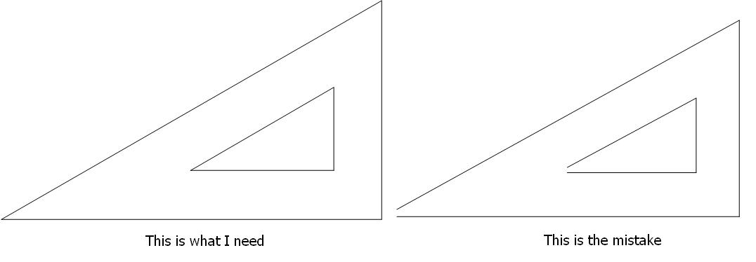

After solve that problem, I tried to add cutter radius compensation and I did it, but there's a mistake.
I f you can see my picture, I have a triangle arragement and after apply G41 or G42, one of the corners of all of them always get open. Days ago I did something similar, but without redefine coordinate system or do some Offset and had no problema so I thought this could be part of the problem or am I wrong?
Mathematically the program is correct that’s why I’m so confused.:(

by the way, usually radius compensation issues are to do with where your start and end points are, tis usually good practice to extend the toolpath before and beyond the finished shape you need to allow the tool to move into correct position when rad comp is turned on, and finish the shape u are after when it is turned off.

Your g code runs fine and is doing exactly what you programed it to do, but I think your a bit confused as to how to start the lead in move for the smaller triangles. A proper start for an inside profile would be in the middle of a line with an arc move and progressing CCW around the profile and overlapping the start point and exit with an arc. This assumes you are using normal end mills and not backwards ones.
Please read:
www.linuxcnc.org/docview/html/gcode_tool...-Radius-Compensation
John

Have you checked that you have the proper lead in move?
"G41 start cutter radius compensation to the left of the programmed line as viewed from the positive end of the axis perpendicular to the plane.
G42 start cutter radius compensation to the right of the programmed line as viewed from the positive end of the axis perpendicular to the plane.
The lead in move must be at least as long as the tool radius and can be a rapid move."
