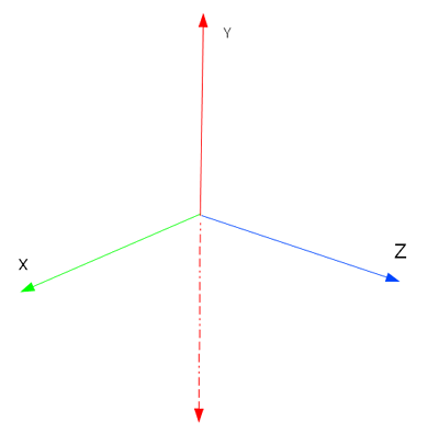

Actually the view I want is not one of the standard views. If you take the standard perspective view I want the Z axis to point where the X axis currently points. I though that I would include a screenshot of what I wanted but when I tried to rotate the axes so that Z was where I wanted it to be I met a problem. I was able to just about rotate Z down to X but then could not rotate around to point along the previous X direction. Obviously the designers have limited the range of rotation which is understandable, I had just assumed before that it would be possible but never tried it.
So I have attached a sketch. Having the Y axis pointing up would change the handedness of the system which would be my preference, though I would also be happy if y pointed down. Both could be achieved if we were allowed to attach a pre or post transform in the ini file
Alan
Alan

You would have to change axis.py or another file to get that orientation AFAIK. I looked but could not find out what or where you you have to change it.
John

AXIS calls methods in glnav.py that change the view. You would need to modify the methods or add one.
It's not entirely clear to me how it works so would require experimentation.

I looked inside usr/bin at axis.py inside there I found the event handlers for the buttons that set the views, the one shown at the end of this message sets the perspective view. I have cut out some of the initial code. So my question is if I add a transformation at the point marked below will that be sufficient? Unfortunately I do not know the purpose of glRotateScene I assume its parameters are position of origin and orientation of axis but does it do anything else? Also if I wanted to create a button for this new view how easy is it to add that button to the UI ? Would I have to run Glade or is it just a case of adding some extra code to axis.py?
Any information would be gratefully received Alan
