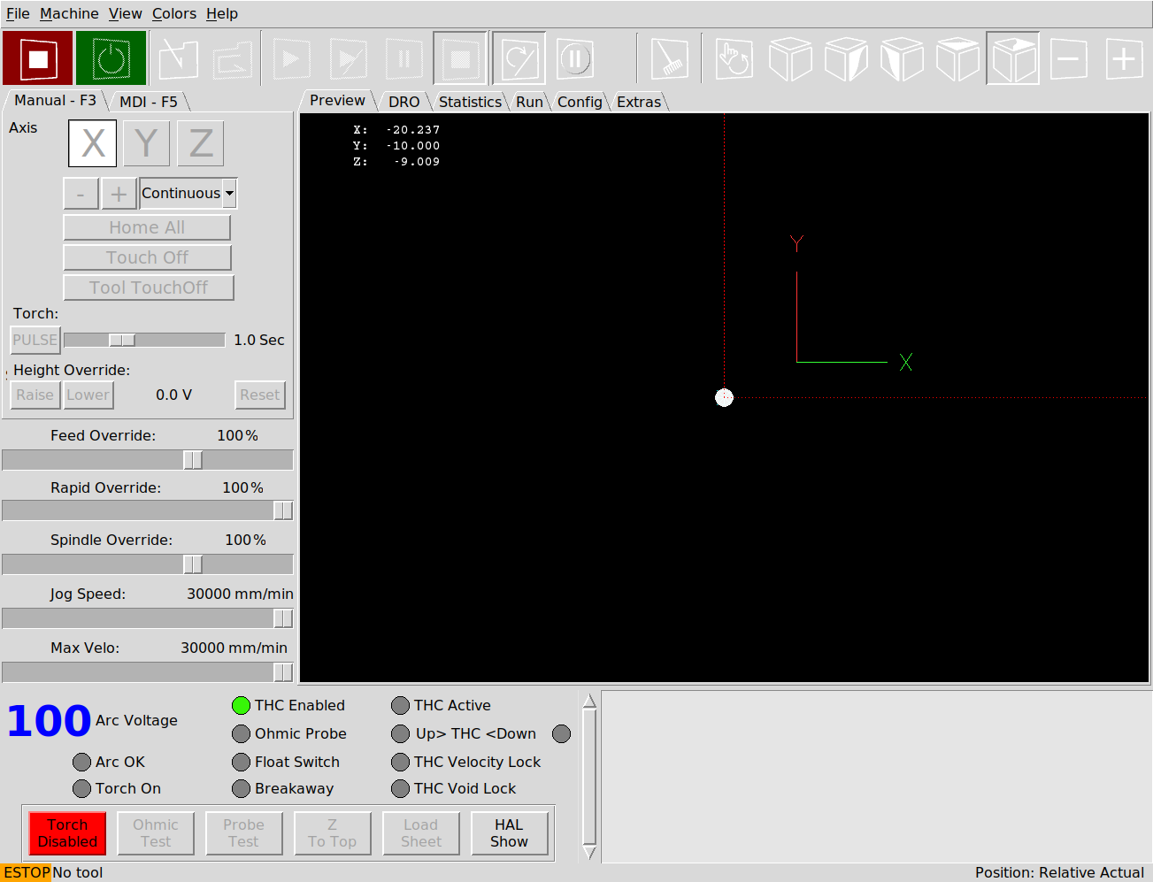

Yes, you can specify either a name which loads a .tcl file from the same directory axis.tcl lives or a path/name in your home directory for a "local" .tcl file

I pushed a
test branch
with a couple of sims in the axis example configs.
Some docs below (restricted to English, my only other language is Strine)
INI Section
Axis Section
INI Section
Axis Section

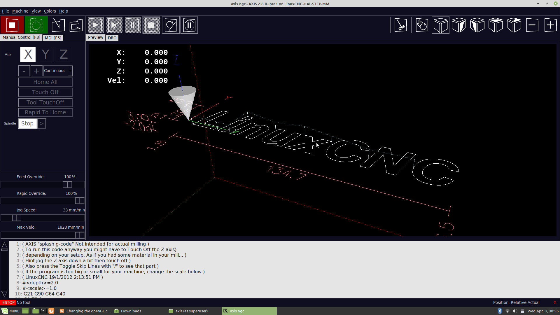

herewith neater versionkey <cntlr -q> to quitkey <h> hides bottom panekey <g> shows bottom paneplease test this if possible, any bugs I will sort out.

Herewith fix

It works for me, restarted linuxcnc a few times and color scheme remains.
using linuxcnc 2.8 latest
