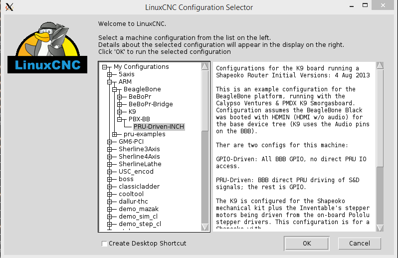

Hello,
I recently setup my mill with linxucnc and after a couple of reboots started getting a configuration error when trying to start up the AXIS interface. I can get to the LinuxCNC Configuration Selector (see image) but after making my choice it craps out. I'm not sure what causing it because I haven't modified anything since I initially set it up. What can I do? Thanks
Here is the terminal output after running linuxcnc &:

A configuration error is preventing LinuxCNC from starting.
More information may be available when running from a terminal.
emc/task/emctaskmain.cc 2962: can't initialize motion
/home/linuxcnc/linuxcnc/bin/milltask exiting
/home/linuxcnc/linuxcnc/scripts/linuxcnc: line 449: 4069 Segmentation fault $EMCTASK -ini "$INIFILE"
Cleanup done

- Fweek
- Posts: 7
15 Apr 2014 03:18 #45950
by Fweek
Ah ok so the linuxcnc image I'm using is a custom one provided by Probotix which I got here www.probotix.com/wiki/index.php/PBX-BB
In regards to changes, no I haven't made any. After I finish writing a fresh image, I would boot it up and get to the AXIS interface window where I would manually step a couple of motors just to test. Then I would shut it down and later when I boot it up I get that error where I can't load the AXIS interface anymore. Haven't made any changes. This has happened twice with two different SD cards.
