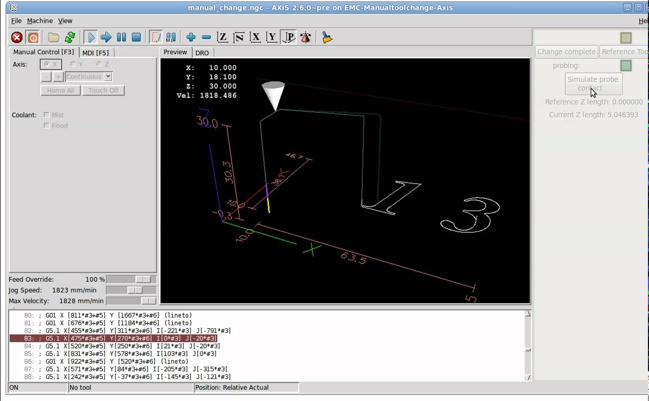

Hi.
I tested remap function on sample config (sim/axis/remap/manual-tool-change...) and im not happy with it.
Problem is preview and extends values (work area measurements). If i use remap, preview will always show work area including patch to tool lenght probe, and work area values is wrong. For me it is not acceptable
Is there another way to auto probe tools with manual change?
Maybe changing hal_manualtoolchange would help?
Maybe someone modified hal_manualtoolchange to use AXIS tool changer with tool probe?

Whatever method (subroutine, mdi, hal_manualtoolchange) i can use that shouldn't be shown on Axis preview as programed moves by G-Code file.
If i had automatic tool changer at X0Y500 and extends (min, max) of my work piece/area was X50 to X100, Y50 to Y100, and tool change with probe in G code, AXIS will show that my work area is X0 to X100 and Y50 to Y500?
For manual tool change and remap, answer is "Yes" ofcourse, and if i get g-code not prepared by me, it is very hard to know what size of material i should use for job since AXIS show wrong job measurement..

I added file to this post. This is screen from sim-demo like i wrote before. As you can see, red lines show wrong numbers becouse remap and tool probe at X10Y10. I think the correct values should be X25.0-X73.5 and Y25.0-Y46.7 (i cant check this now for sure).can you give example as you say axis is giving wrong job measurment ?
HSM Expresshow are you preparing gcode ?
Yes, but if i get GCode from other person? And script for boundary area will not work prop. too.i use a cam program that will output a job sheet , this gives material to use and extents
it should not be difficult to output this information ,
I just want AXIS preview (red lines) look like there is no remap function for tool change. If my work have dim. 100x100, that red lines should show. Tool changing and probing is special moves, and boundary lines shouldn't include this.do i understand that you want to change tools outside of the boundary area ( shown in red ) in axis

I can actually think of a way to do this. You could insert an "offset" HAL component between position-cmd and stepgen.position-cmd.
Tool change positions would then be inside the normal envelope, but the physical axis position would be outside.
www.linuxcnc.org/docs/html/man/man9/offset.9.html
You could drive the offset value with a mux2 component and a suitable bit output. Stepgen should be able to limit the accel and velocity while the offset is applied. Or a limit3 component can be used.

Yes. If i use REMAP for manual tool changing and auto probe tool (im using subroutine), preview will change Extents, i dont want that. I'v checked (AXIS,show)/(AXIS,hide) functions, and included them into subroutine file, but it must be for something else.Is your problem that the G-code preview shows the toolchange moves and you don't want that?

The extents are calculated when the G-code is loaded.
It might be possible to exit your remapped subs before any movement occurs during the preview stage.
Try an IF around the remap moves:
O100 IF [#<_task> EQ 1]
O100 ENDIF
