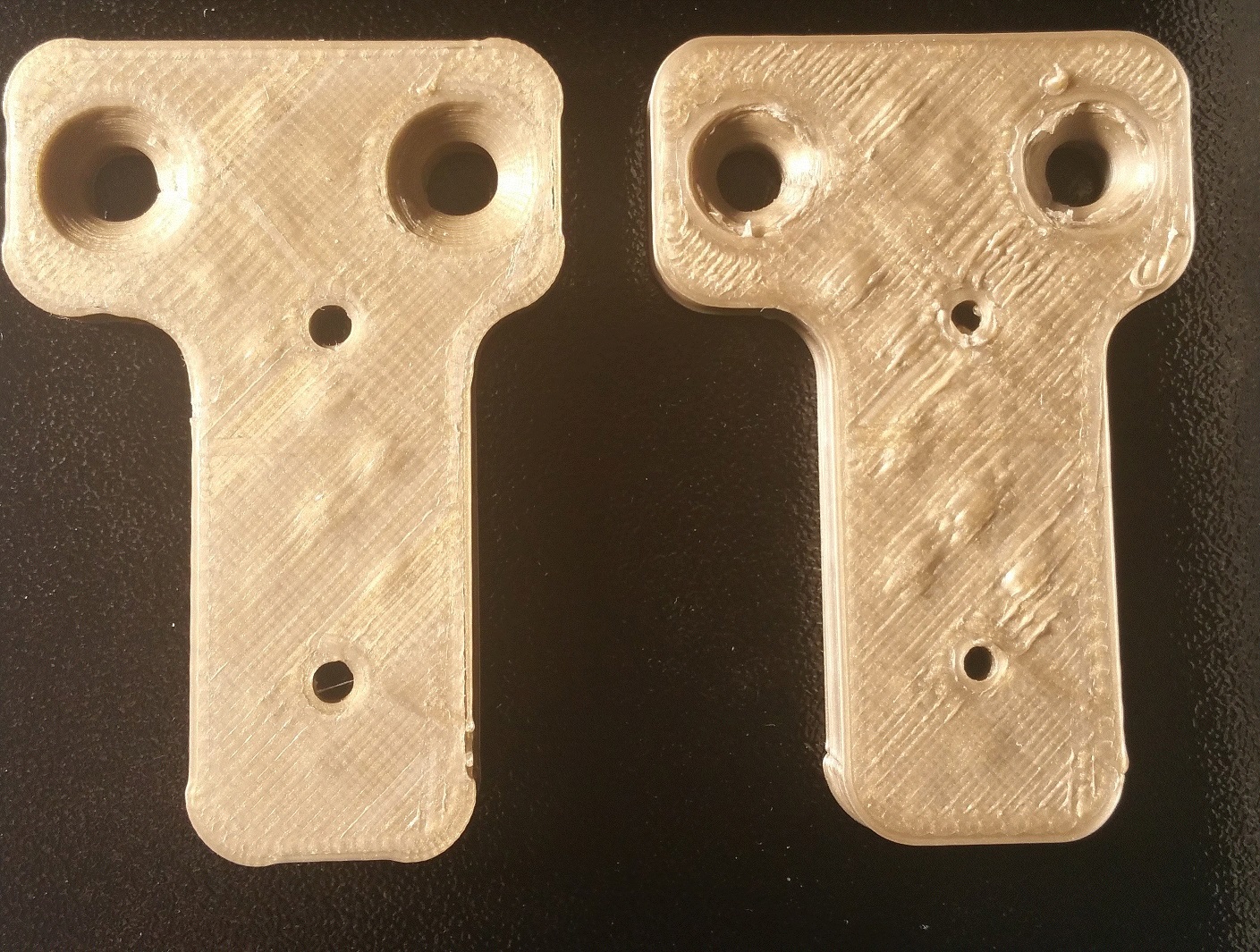

We are trying to generate the 4th coordinates by a component that reads the velocity of X and Y.
In this way the trajectory planner, seems to work properly and we have a better extrusion in the corner.
The problem was that when the machine did rapid movements, or movements without extrusion we needed to disconnect the 4th axis from the X and Y. If there was a retraction in the gcode, the machine can follow that retraction, without conversions or post processing.
In the picture attached, you can see the difference in the corners. On the left with normally sliced gcode, on the right with the nozzle linked to the X and Y velocity.
Thank you
