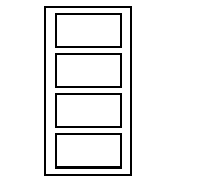

I start with a simple few line drawing of boxes and maybe some text in the boxes. like this.

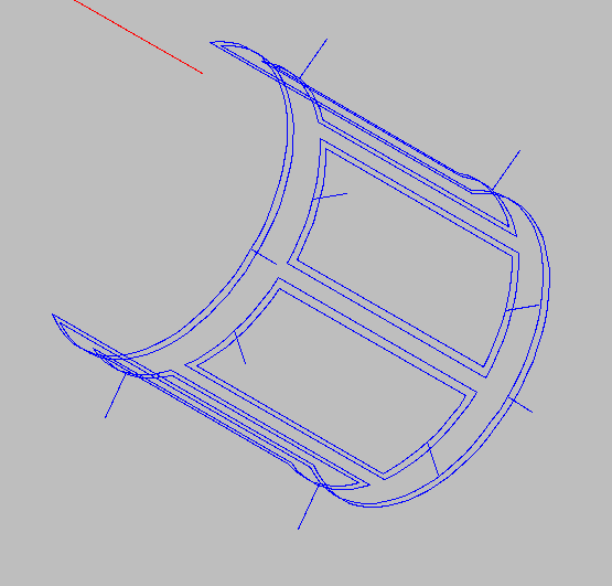

I then wrap the image and convert to G-code for the A-axis and get an image like this.

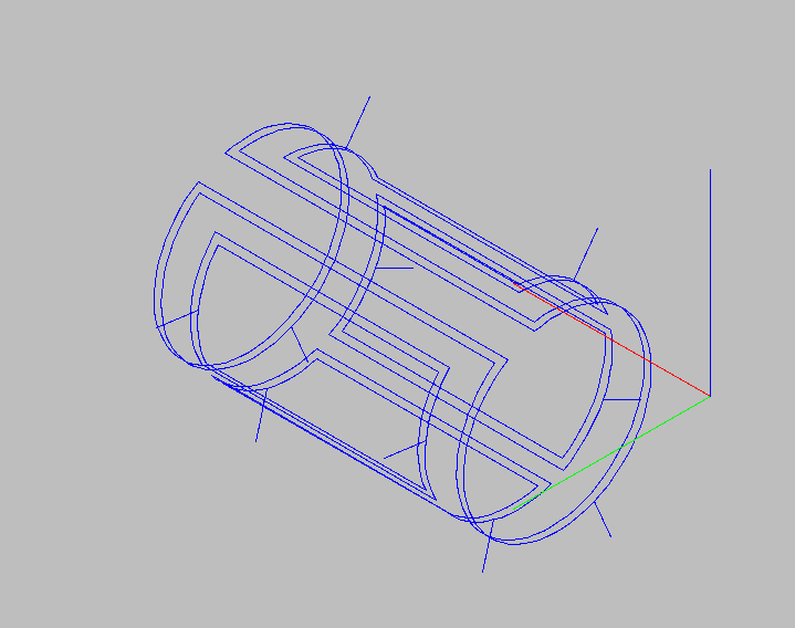

or this.
The longer I look at it the more it changes from front to back view, (my eyes and optical illusions I think).
From this view I can plan where to put the text if any and take the pen clip dimensions into account for the wrap.

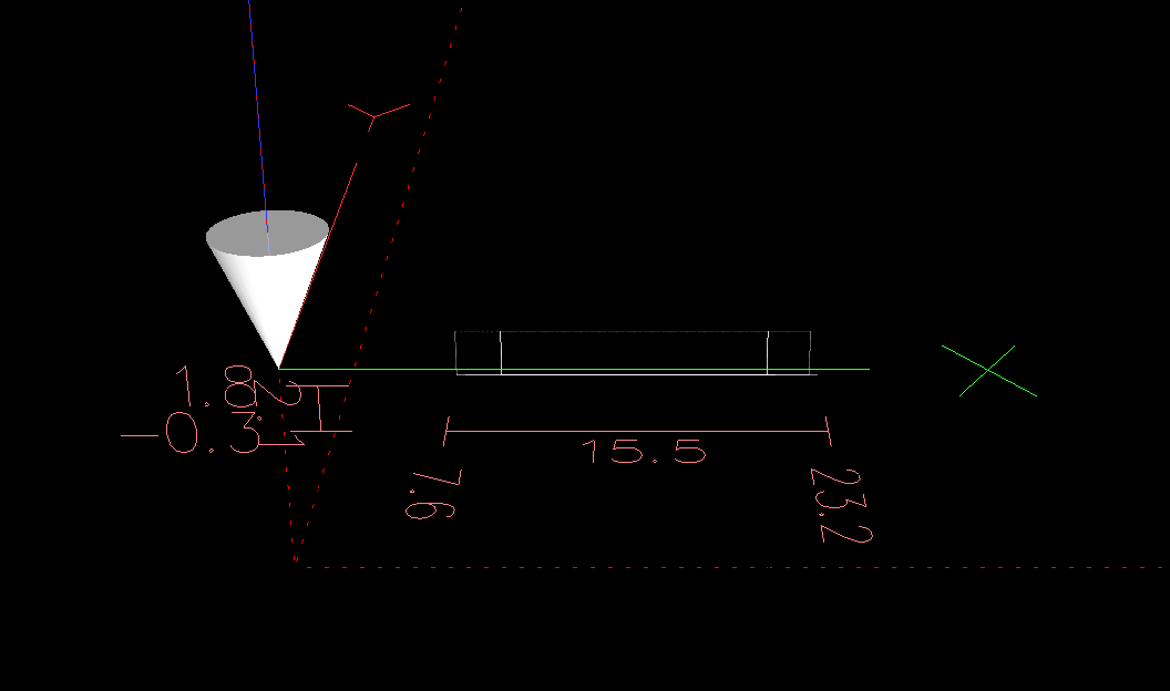

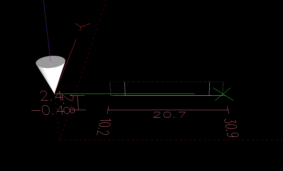

I then open up my axis sim machine and load my code to check my tool path and all I see is this.
Of course no matter what code I load to the fourth axis I will only ever see the same view.
Is there any facility that will give me a rotary cylinder view to track my engraving before I cock up a very expensive item?
