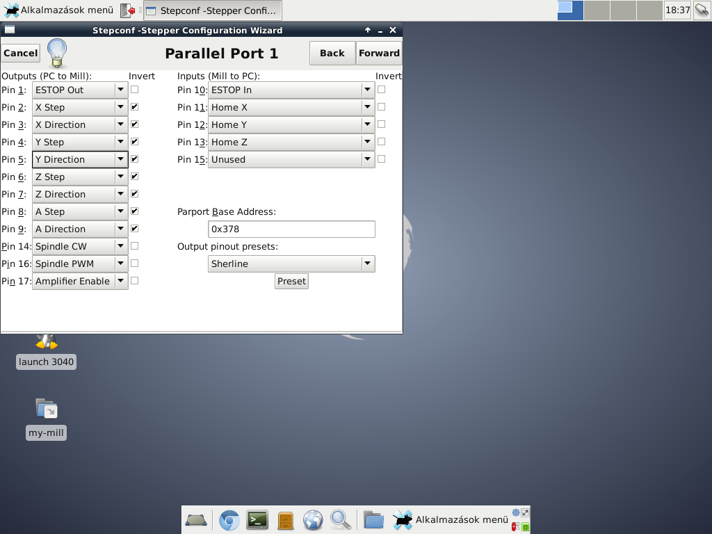

Hello!
I managed to set the plane but the following error occurred:
The X axis is not scrolls but also disabled. The rest works well.
EMC started tentatively but there are also prohibited in the X axis.
The spindle in turn reacts button Moves the X axis. What can be wrong?

Check the parallel port pins. It seems that the parallel port pins that should control the spindle are incorrectly set in Hal to connect to the X axis.
Post what parallel port pins your hardware uses. What parallel port pins does the X axis use on your hardware?
Rick G

I started to think and I got so far that the problem is with the controller. I started swapping panels in the shaft if the x-axis is bad it will not work on the Y axis. The panels work well. I started wagered the box connectors for the parallel port that they go to the X, Y, Z and A axes of the panel schedule. First of all I changed the X and Y axis but still the X axis didn't work. Tried on the Emc but the X axis didn't react then the two adjacent X and A terminals are reversed. The X, Y, Z axes are works on the EMC the problem is with the A axis i think its' an stepconf setup error.
