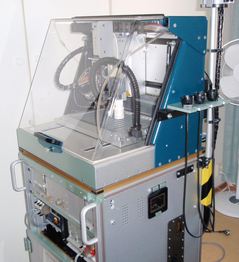

- Iselman
- Posts: 5
31 Aug 2017 21:31 #98313
by Iselman
Replied by Iselman on topic Backplot trail changing colour during millimg
Now I got it, it is really realtime computer resource problem concerning processor speed, amount of memory and operating system capability.
My controller computers are older PCs inside the cabinet, under the rebuild Isel 3-axis desktop mill..
Thanks for your attention!
Iselman
Here is a picture of my cnc system.
Iselman
