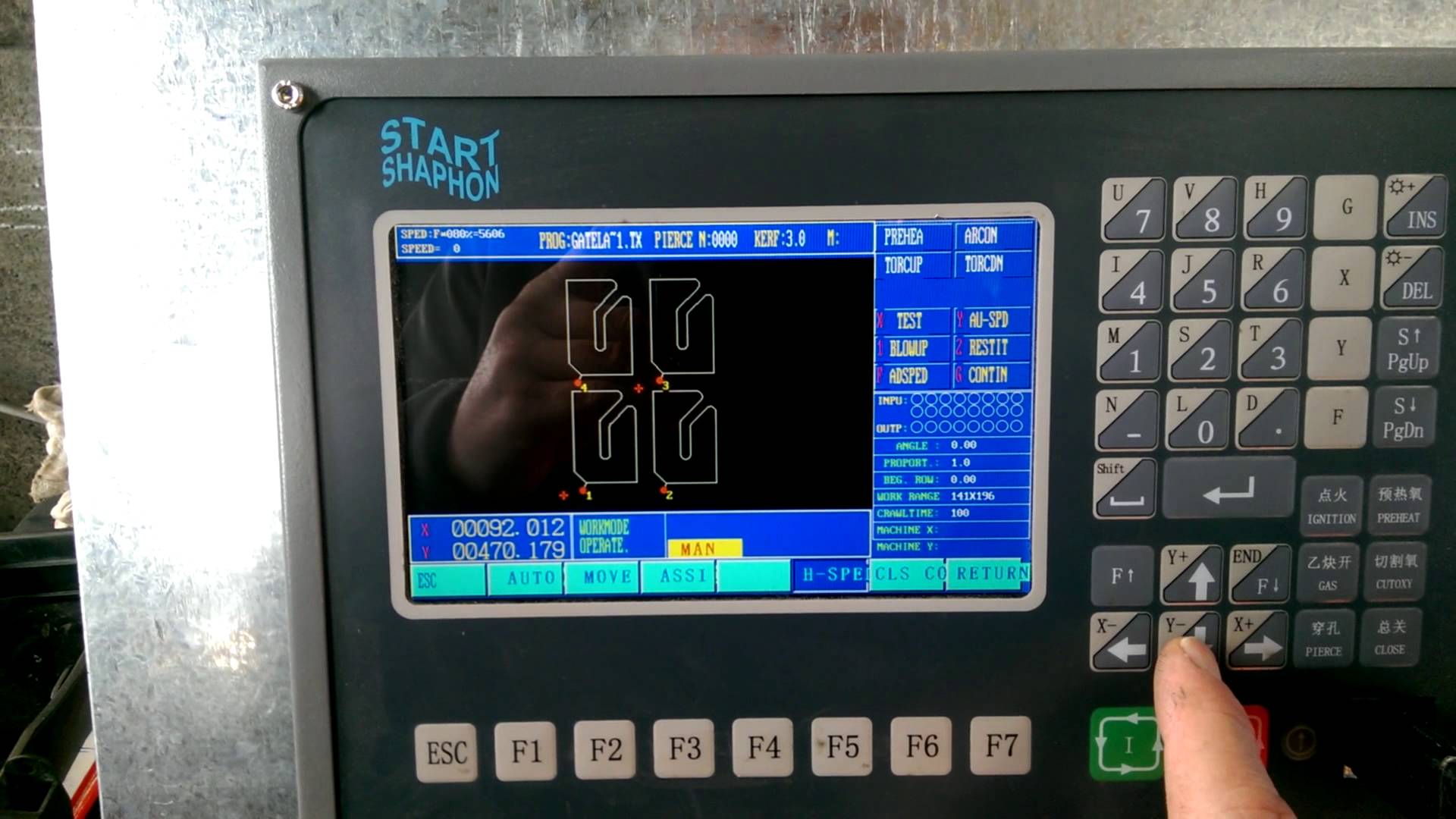

I'm trying to run CNC plasma using linuxcnc and axis interface. While cutting a drawing we have multiple parts to be cut, and often times we don't need some parts not to be cut. Every section that will be cut starts with M03 and ends with M05. Can I not just display a section number for each section inside M03 and M05 on the drawing display area of the axis GUI. Actually, this is something I have seen in Chinese plasma CNC controllers, they call it pierce number, and when entered by the operator plasma directly cut that section. Those controllers also offer flexibility to cut from the current position or machines reference position, though this stuff can be done in linuxcnc with help of G-codes. Anyone's help will be greatly appreciated.
Thank You,
Kunal
P.S.: In the image attached you can see cut number given at the start of each section, starting from number 1 and ending at number 4
Thank You,
Kunal

You can do something similar with subroutines. This would cut O1, O2 and O5 bus skip O4 and O3
You can use descriptive names too, using <> as string delimiters

Thank you Andy for your response, but this will be in the G-code editor section I need to view the section number where the G-code is rendered.

I don't think you can do that with the current code. The G-code preview only displays G-code, not arbitrary graphics.
